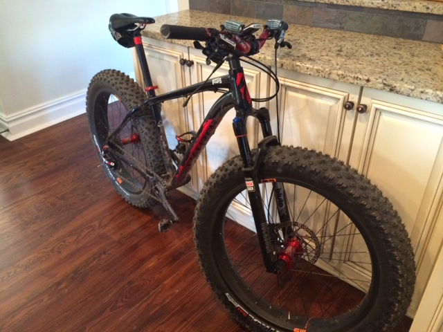

I had knapps install a bluto fork and build up some Enduroworx carbon wheels , this thing is unstoppable now !
How much it weigh?
Not sure i did it because i broke the stock rear rim twice and wanted front suspension , I'm not really worried about weight ,but wanted durability i also went 1x11 . its a solid ride now . I haven't touched my FS29er since i threw a leg over the Fatboy.I am a happy specialized owner !

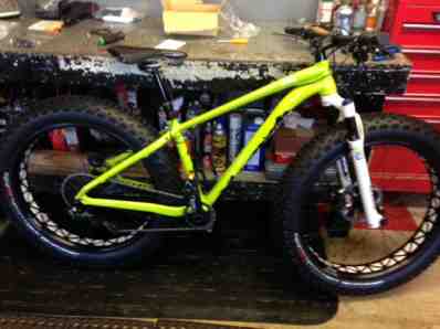

I got the new Fatboy Pro , it is awesome, rolls over and thru all the rock gardens with that Bluto fork, still climbs like a champ. The spec is ridiculous: 1x11, carbon Next cranks, xt brakes , dropper post etc. I had WYCOFF CYCLES set up the tires tubeless and saved a pound. ImageUploadedByTapatalk1415750389.930534.jpg

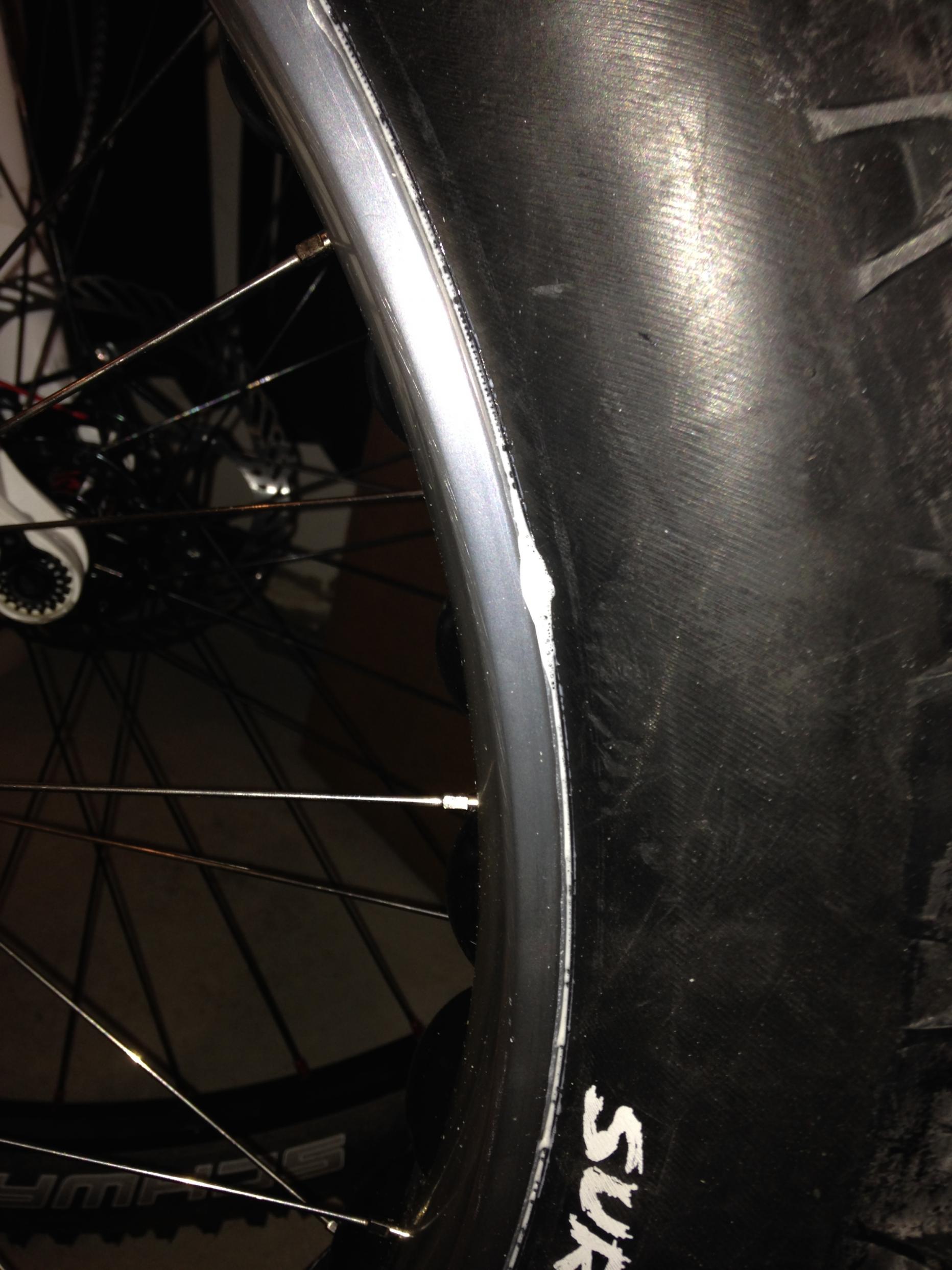

This is from last year but I never got around posting it. Today I took the cobwebs of my fat bike (it has been sitting in my garage since March) and the tires still had air in them.
The wheels are Clownshoes and the tires Bud & Lou.
- Put 1 lap of 1" gorilla tape against each border of the rim, which is enough to overlap the Surly tape that covers the holes in the rims.
- Then put a little square of the same tape covering the valve hole, and put the valve through it.
- Then mount the tire leaving a bit of a side open, add Stans through that (I used 3 scoops), and mount the tire completely.
- Then tie a jute yarn around the tire, through the middle of the rim as tight as possible (any other type of yarn that would snap relatively easy should work), so it pushes the beads of the tire against the borders of the rim.
- Pump the tire. You should be able to use a floor pump. I used that and I got it to seal on the first try (both wheels). If you don't get a good seal and the pump is not enough, a compressor should do the trick.
I used this setup last winter with very low pressure (down to 2 psi in soft snow) and it held really well. Today I added new Stans and was able to seal them back up with the pump again.
Although this worked really well for me I shared this method with a guy that builds wheels for a living (including fat wheels) and he didn't have luck with it, so I don't know if I just got lucky.
