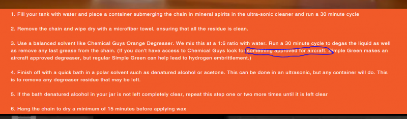

Silca website describes the solvents needed to clean chain. I'm particularly surprised by aerospace use approved degreaser that is recommended:
Overkill?
Overkill?
Not sure. I think aerospace is a common approval that solvent brands use.
