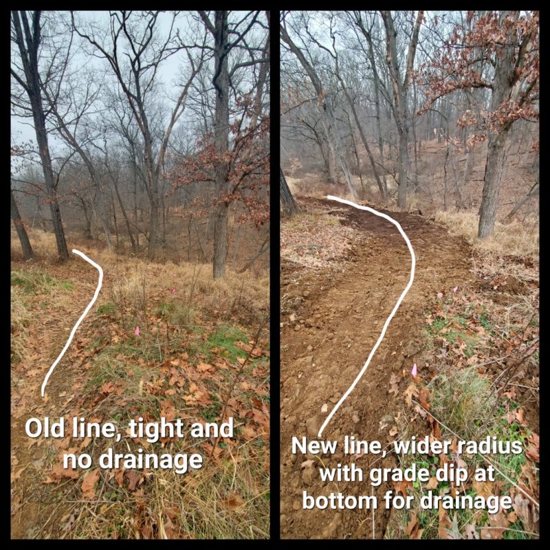

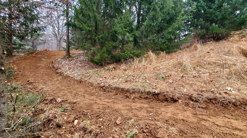

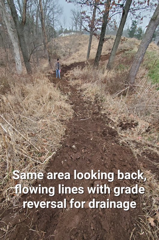

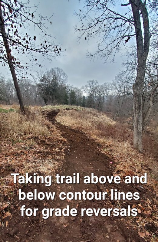

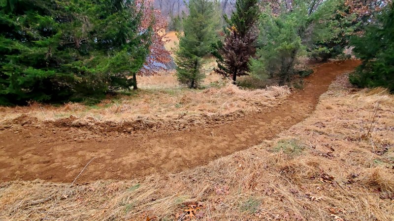

Getting all things to align for a new trail build is extremely difficult; permission from landowner, volunteers, design, funding, timeline...
So when a couple friends asked for help with their build, I did not hesitate to volunteer.
@Kirt and @Norm , Jorba reps for Chimney Rock/Cromwell, got the green light from Bridewater Township to rework trails built by a contractor a year ago on the Cromwell property.

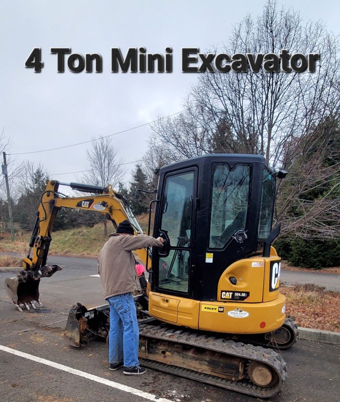

Fortunately I was off for the holidays last week and was able to run a 4 ton mini excavator to shape trails with flowing lines. This machine is 2x the size of typical trail excavators but fortunately the site was relatively open to fit it. With twice the power and added stability and reach, this machine could hog out rock and soil needed to carve turns.
We buttoned up the rough in yesterday, with the rain, finish work will have to wait. Thank you to the trail volunteers who came out during the week.
This trail network, roughly 5-6miles is a contrast to the more raw, greater elevation CR across the road. As such CR/Crom offers greater diversity, I'd like to think it has the potential to please all trail users.
As mentioned previously all this awesomeness takes a lot to put together. Kirt and Norm not only managed the project but were able to get funding from Jersey Off Road Bicycle Association to secure an excavator and work with the owner of Hi Tech Landscaping who donated a labor force.
Everyone wants to know where Cromwell is, but I hope after reading this everyone will want to become a Jorba member and donate to projects like this throughout NJ, as well as get involved with trail maintenance locally.
We look forward to the opening of Cromwell this summer. Please don't ride there yet it's soft, not finished and technically not opened.

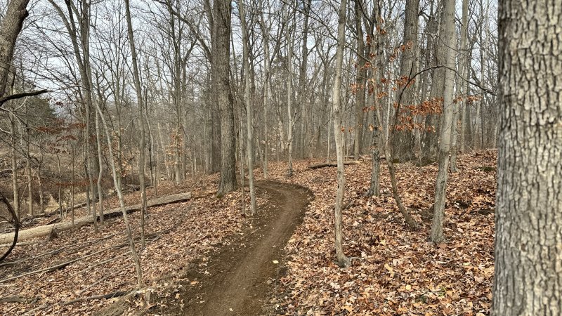

First off, thank you all…. I was there on Monday morning and blown away by the work you’ve all put in. I had seen the pictures posted and thought it was just some maintenance being done in spots, but wow.. just wow. The pictures do not capture the work and effort that’s been put in.
I’ve been riding Cromwell for a while and it’s been something different from the regular CR trails but not something I’d hit every time out. Now, it stands as a trail system on its own. I feel like you can spend hours there and not feel the need to cross the street.
Thank you to all that are involved. @Kirt @Norm @pooriggy, Hi-Tech, Jorba and all of the volunteers and magicians:
Thank you, Thank you, Thank you. 🙏🏼
