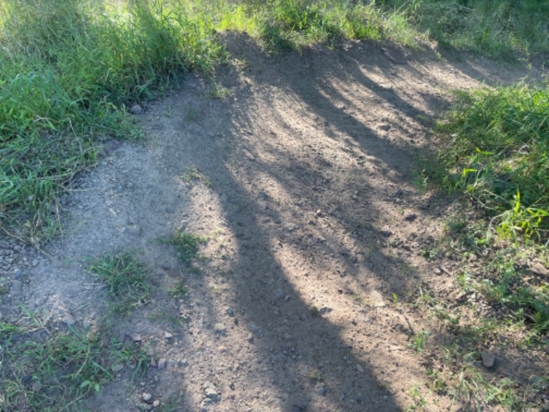

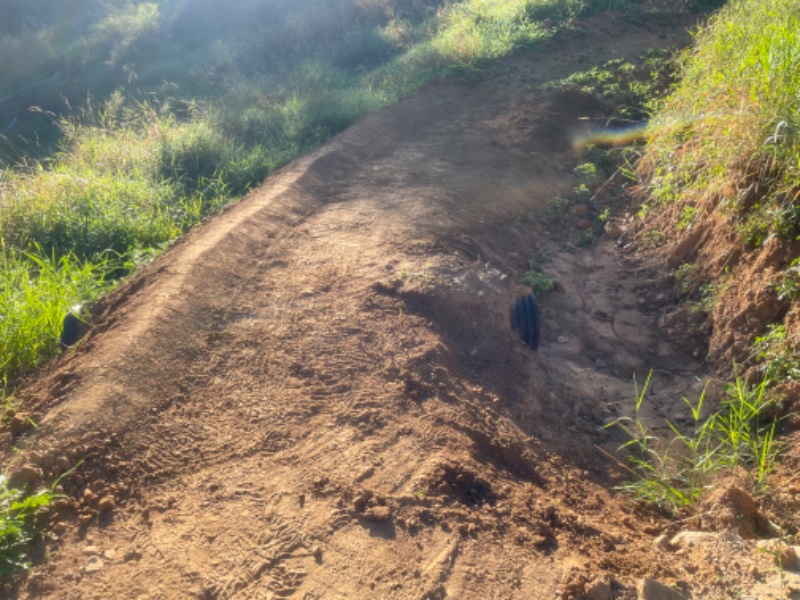

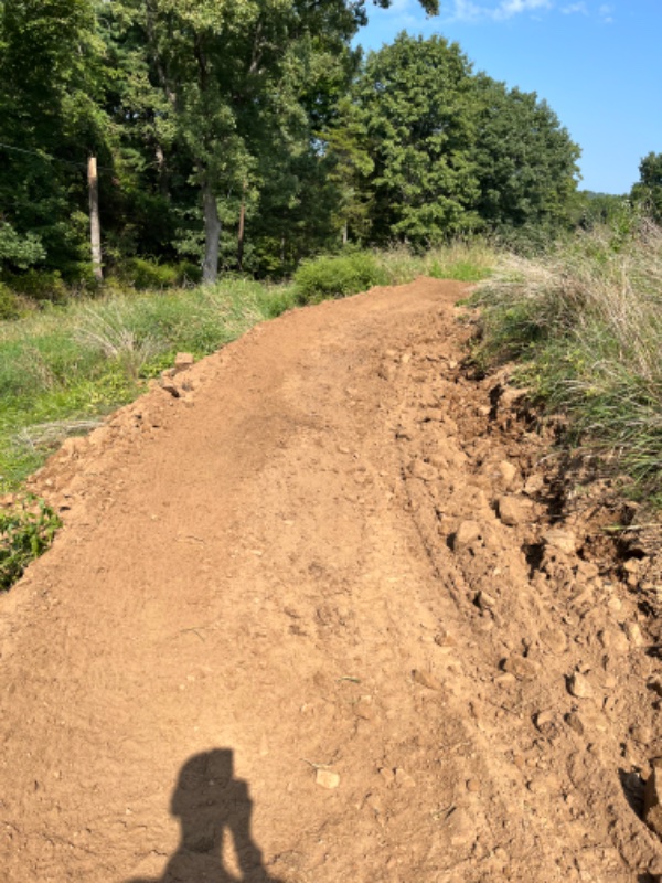

Spent a few hours today trying to make this section weatherproof. Saw that a heavy storm cell cam though after. Fingers crossed 🤞 I have got the drainage working
We got very little rain from several cells that passed by.

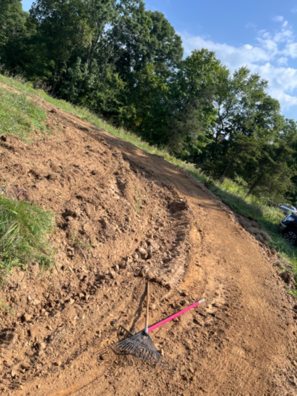

Took the opportunity between the rain sessions today to get out to Cromwell and do more work. As you can see from the pic below, a great, great advantage is that there's a telephone pole here. Or...that I can drive to a spot 10 feet from where I want to work. I think the furthest this trail is from a spot you can park the car is maybe 100 feet. Maybe.
STB/Kevin texted me and suggested instead of a berm I may want an angled tread and I totally agree. That said, digging this stuff is work. With the rain, digging is far easier and I took 1.5 hours and did another 10 feet of the trail. I think what I did today is closer to what I want the whole turn to look like. Probably another 10 feet to go until I hit the drop/ish thing that sends you into this. I fixed that up a bit but that will need more work. I was basically trying to form mud with that.
Also you can see the stuff I did Monday held a lot of water today so I'll need to rework that when it dries out. That was far too wet to bother with.
Anyway, getting there, foot by foot.

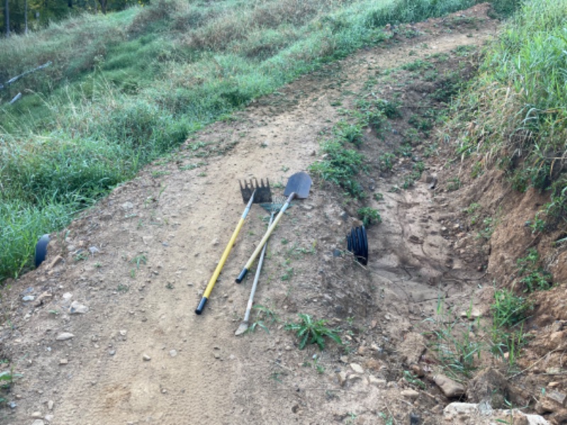

I went back out and worked on this in the afternoon. I did about 5 more feet uphill from this and I redid 5 more feet where the berm is low in the pic above. I also did some weed whacking in the immediate area.
This is starting to get pretty good but it’s gonna take some time to finish. No pics again because I got other shit on my mind I guess.

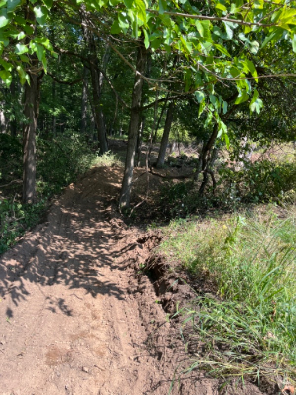

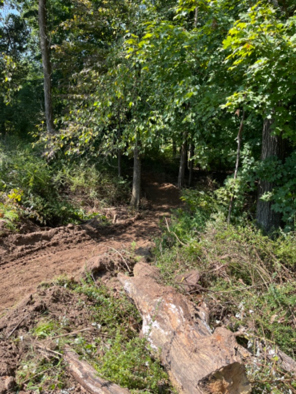

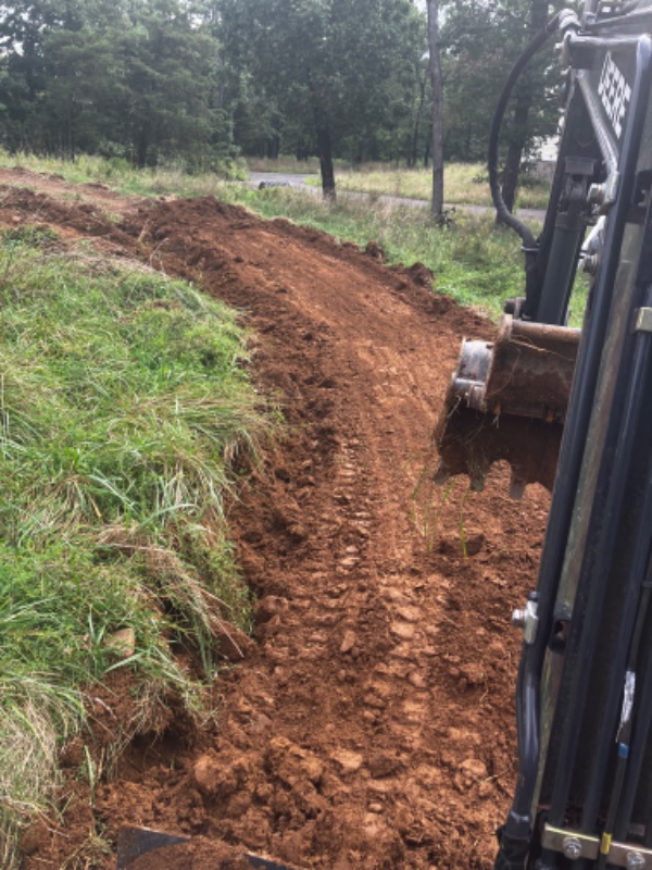

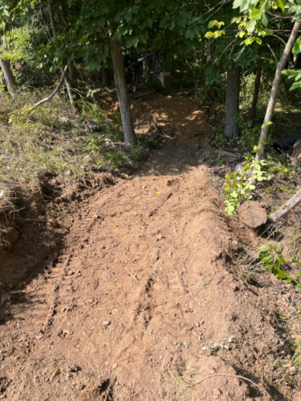

@jdog and I were back out yesterday morning. He finished cleaning up the top of the Stop trail. Really happy with the changes he made as well as the added drainage. Come Fall we can focus on the hand work/fine tuning from top to bottom, which Norm has started in the middle.
Then we started another project that I’m hoping will be a nice addition. It’s not a huge project, so figuring 1 or 2 more sessions to knock it out.
I’m mostly posting this update to thank Jason for continuing to come out and run the machine. It is a game changer for us in lots of ways.

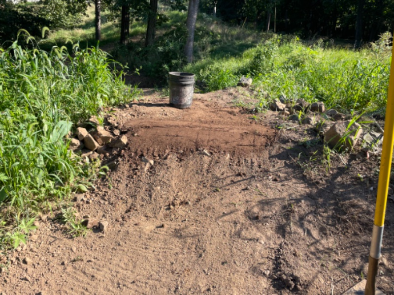

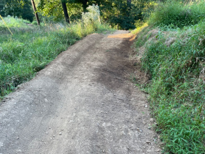

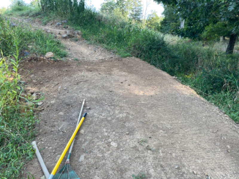

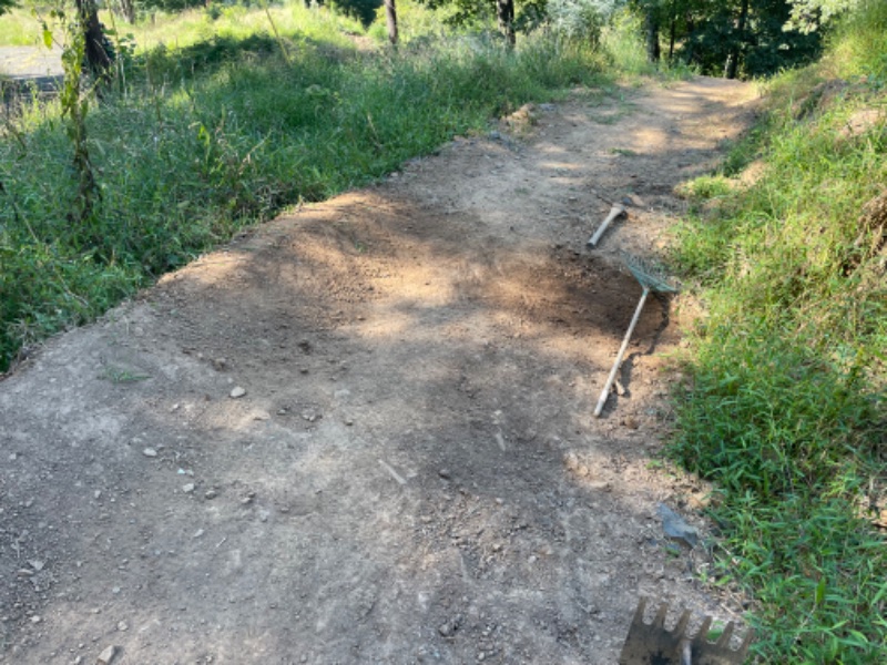

Was out again today for a ride & TM session. First was that long sweeping berm I have been working on. First is the entrance which I extended 3 feet, and will eventually start at the step-down in the pic. The second is the exit which I extended 4 feet. It's getting closer but will need a few more sessions. I could probably knock it all out in 1 but it's boring work and I just do a little more each time.
Then I worked on the jump-to-tabletop which we built last week. The exit of this is tight, and if you don't know it well, you'll end up in the rough. I actually do know it, and I had to full lock one run today. It's getting really fast & fun so this is a result of making it better. Hard to see here but I chipped away more of the hill/rough. Second pic is the tabletop which I added a bunch of dirt to. This will take a few more sessions to get right and will probably need to be rebuilt every year.

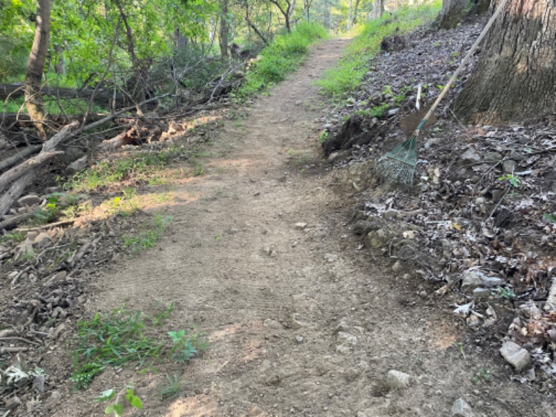

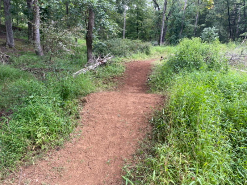

I then moved down the trail and blew out the rubble from the pavement crossing to the log-drop-ish thing. The first berm after the pavement is...better. Won't lie, this is not good. But it's better. The dirt here is garbage so we're going to source dirt from elsewhere and build this up better. It also needs to be weed whacked but I forgot to bring it with me today.
Ok down the trail a bit more, approaching the low point before the rise to that double-thing-that-isn't-quite-right-yet that we worked on last week. Thinking here is that the loose rocks make it harder to hit those properly. I rode it after and it's better but it needs something. IDK what that is yet.
I would say this trail, right now, is running as well as it ever has. You should go out and ride it. Then come help next time we go out.

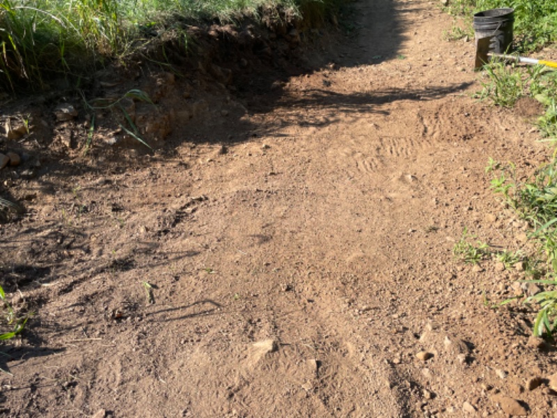

I decided to skip Fun Monday because I wanted to get some work in tonight. Going up the turn towards the step-down (which I am pretty sure I am going to get rid of eventually). This is "done enough" but I will end up having to go all the way up to make sure the water is draining properly. I am not worried about it right now as it's perfectly fine. I'll do a few feet every time I go out and eventually we'll get it done.
The exit is nearly complete. I kinda want to go all the way to the launch but for all intents & purposes, this is good to go. So the 50 foot berm is kinda mostly done as a version 1. I'll need to dig some more but that will be easier digging, and is not critical.

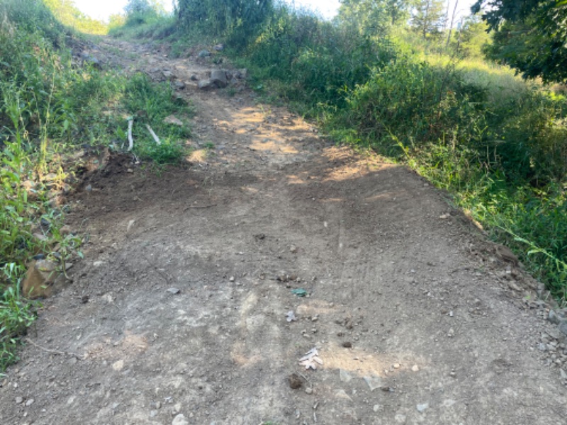

Real time updates. This is the before/after of the turn before the one I was working on in the previous post.
Not trying to be a d!ck and criticize, but just want to offer advice. For this specific turn, it looks more like a curb than a berm. I would dig out a bunch of dirt in the circled areas and dig a smooth transition from the outside of your turn down to the level of the inside low spot. This would make a much bigger berm to hold you better and you can use all the dirt you dig out to build up the outside of this turn or other features.
