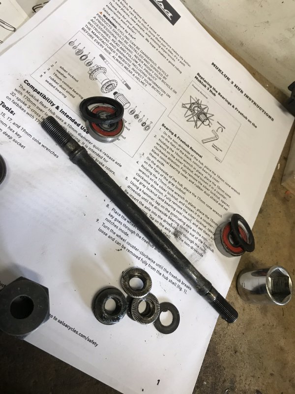

sorry @jimvreeland one more clarifying question...if i did want to replace the freehub, i obviously have to remove the axle.
one of the issues i'm having is knocking the axle all the way through the hub (drive side or non-drive side). it seems to get held up a bit somewhere within the hub, even with all of the locknuts & washers removed. i have a feeling it's somehow getting hung-up by that tiny little bulge on the axle (see my crappy picture below).
i'm afraid if i force it through i will ruin the hub and definitely will need that new I9/Nextie wheel set.
however, before i commit to that, i want to just try to get an 11mm hex into the freehub to give it a half turn to potentially remove some of that play.
so, do i need to just man up and push the axle through, or am i missing something else?
thanks!
pygmypony
#12
quick hub-pdate...
i picked up the park tool AV-5 axle vise and that was the trick! i was finally able to get the stubborn cone nut off, and then i got the axle out by pulling it through the non-drive side. basically the "lip" that sits against the bearing on the freehub/drive side, is larger than the non-drive side lip, so you can only pull the axle through the non-drive side.
once i had the axle out, i was able to get the 11mm hex into the freewheel and it was SO LOOSE! i tightened it up, reinstalled everything, and it seems to be spinning pretty nicely! time will tell from here!
