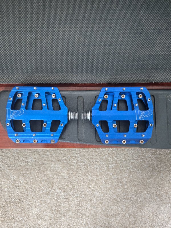

For the life of me I can not find an L or R on these pedals. They've been sitting in my parts bin for a few years and I want to mount them on my commuting bike. Should I assume, going by the logos that the left is the left and the right in the right(looking down from riding position)? Fanks.

The right pedal will have a right-hand thread and the left will have a left-hand thread.
When you look at the pedals from the end, you'll notice a trapezoidal shape. The top of the pedal on each side will point towards the front of the bike. Many enduro and DH style clipless pedals are the same way.
I don't know but I can just look at the way the threads are cut and see which is right or left.

In the picture in the first post, the right pedal is your drive-side. If you still have them sitting there, this is the answer. If not, here is a 100% graphically accurate representation:
Treads angled generally like this are drive side:
And non-drive side are generaly angled this way:
If you can't tell the difference, it's because you're old and your eyesight sucks. Either grab the readers or give them to your kid and ask which way they angle.
