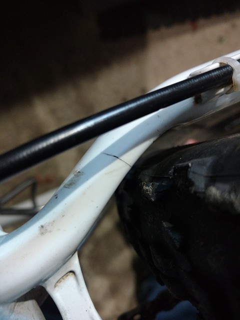

After a thorough breakdown/cleaning/re-greasing of my beloved El Mariachi, it looks as if I have a crack in the drive side chain stay.
Anyone have any experience working with a bike builder that repairs steel frames that you would recommend?

Very disappointed in your cracking such an awesome bike and in an even more awesome color! I think you may have to ride 2 el mariachis...concurrently! Being steel the fix should be feasible, I believe you may want to have some gusseting added to the obvious weak point, on both chainstays. BTW, had it been a large I would have suggested to pay me to pick up the cadaver...

Bummer dude! Alls I can say is good luck finding a builder who can get it done in this decade. That's why I gave up on fixing steel misfit.

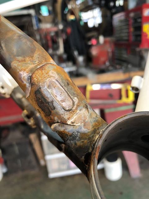

Bummer. I had a Niner SIR9 crack on the non-driveside chainstay in the dimple area behind the BB. Had it fixed at Bilenky Cycle Works in Philly. While it did get fixed and is still being ridden by a friend, it took 1yr and 1 day to get it back to me. I got tired of waiting. Ordered and took delivery of an IndyFab in 12wks and was riding it for 3mos prior to getting the SIR9 back. Can't hurt to check.
Edit: pics added of crack and repair.

Thank you. This is perfect. Luckily, I have the old '13 El Mariachi hanging in my garage. I'll swap everything over while the '16 gets repaired. Thinking of going with something new as well built for my riding/eating style.

Weaver Cycle Works in Collingswood is defunct I believe but you may be able to get him to do a repair.

My dad is a welder and I've had him fix some aluminum bikes, but it just puts off buying a new bike for a bit longer. If it's not heat treated properly after, it weakens the metal around it or something and they both cracked about a year or less later, close to the repairs.
