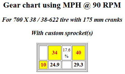

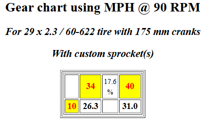

I’m trying to figure out the gearing. So 34 front with an Eagle 50 rear 12 speed. How does that compare to a typical gravel bike one by setup?
All of the issues are high end (high road speed). The lowest you can go is 10 tooth on the cassette, so that is the limitation. I ran a 38 on my old cross/gravel bike and din't have too much problem. Only if I was riding with faster people on the road where I really was spinning out to keep up.

The problem with these hardtail conversions is the front chainring clearance, I think you’d need to clear a 40 minimum to make it work and work well enough to go fast enough for it to be fun.
Let’s face it, having to coast down a long gravel downhill that you could be pedaling, but can’t since you’re in 34x11 or something, that sucks. You don’t have to race to want to go fast downhill!
If I had went 2x I don't think top end would have been a problem, but for me, and where and how I ride it, the 1x and smaller front ring make sense. It's seen more Wayway fire road, Kittitinny,and Sussex Branch/P-Kill rail trail than what most consider "gravel". With the dropper, and MTB wheels, it's definitely single track capable, and while not necessarily the best tool for the job, it's hella fun, which is exactly what I was looking for. But with a some changes in drivetrain, I'm sure it could keep up just fine if ridden by someone a bit fitter, with a more "road"( and not saying that like it's a bad thing ) type mentality than myself.
Thanks guys for the input. I’m trying to figure out top end as Bedminster gravel appears to be a combo of smooth gravel and road so am looking to figure out if the top end is tall enough on my bike. I am still trying to figure out how a 12 speed 34 ring and 50 Eagle (pie plate) cassette compares to a one by gravel bike. Not sure what manufacturers are running these days. Am going to install 29 2.25” tires on the bike. 34t is the largest the bike will fit

You’ll be fine running that. Give it a couple hundred miles before you make any changes. This way you’ll be 100% sure you’re going in the right direction. If you change it at all.
