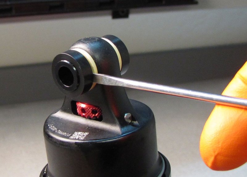

Once you press the inner spacer out the black (aluminum?) spacers should fall out, then I slip a cutter blade between the white bushing and the actual shock. Full disclosure I did break the o-rings, but I believe those where between the black and the white bushing (I maybe wrong). Once the cutter blade is under the lip of the bushing try and slide it around the perimeter of the bushing and it should loosen enough to come out.I had to put this aside for a few days due to my level of annoyance. I ordered an air can service kit and also replacement shock bushing hardware, figuring it wasn't a bad idea to have those on hand even if they weren't necessary to solve the current issue.

Has anyone done one of these 7 piece crush washer assemblies? Fox shows removal of the black delrin spacers just using a flathead screwdriver, but there's zero gap to get anything in there and they're press fit on pretty tightly. I get that it would be more expensive, but if they had machined some wrench flats on there it seemingly would be pretty easy. Ultimately I may just try pressing the interior pin out instead there are o-rings in there that I'd ideally like to save and feels like a lot of force would be required.
(Fox instructions, lol)

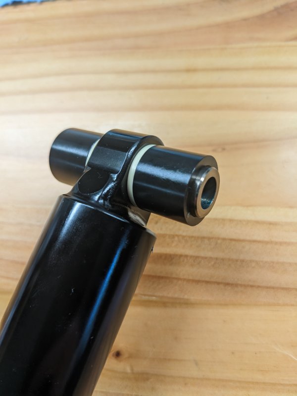

For test purposes only any trunion shock that is shorter would work just to compress a lil and see if its any differentI was able to press everything out without too much issue. And...no change, still something knocking. Guess I'll try a shock air can service next since I at least know how to remove the hardware!
Edit: didn't replace any of the air can seals because everything looked fine. Going to see if I can track down a 225x75mm trunnion shock to swap in to continue the process of elimination. Noise definitely sounds like it's coming from the shock.
