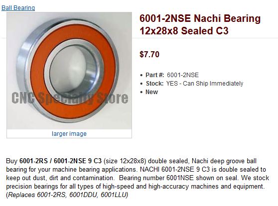

Called Trek. Part number for axle kit is part #429211. Bearings are part #410427 (which is a standard 6001 bearing). Bearing size is 28mm x 12mm x 8mm. Axle kit is proprietary and needs to ordered through dealer. Called dealer. $29.99 + $3 shipping. As @w_b stated, the bearings are cheap and common. So, I'm ordering a couple of them first. Thanks for the various inputs.
cheapest I found on a quick search. double sealed is nice but not absolutely necessary. If it was for a jet ski pump, yes absolutely; but for your app you can get away with single, or even shielded.
Even the Timken version is only like $12.
