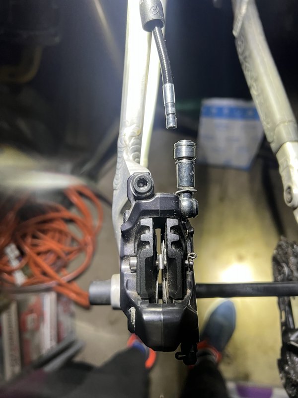

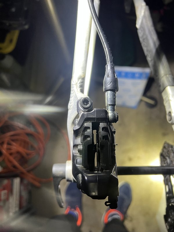

I mentioned it months ago but I don’t think I ever shared…I did fit a Formula speedlock adapter to my rear brake Shimano caliper so I could bleed the rear brake removing the whole system from the frame.I had to source specific o-rings for the banjo adapter. Turns out the banjo to caliper (Formula to Shimano) using the o-rings I sized is pretty tight and doesn’t leak, the speedlock hose to the adapter, a Formula proprietary system…leaky! Moving back to regular banjo hose soon.
As you can see the hose side can sneak everywhere the actual hose can , it’s the same outer diameter.

I could not locate the proper adapter, they only sell a Formula specific adapter for the lever. I had great hope for this setup, unfortunately the very system that I inspired the setup is the one leaking, not the customized one...damn italians!
