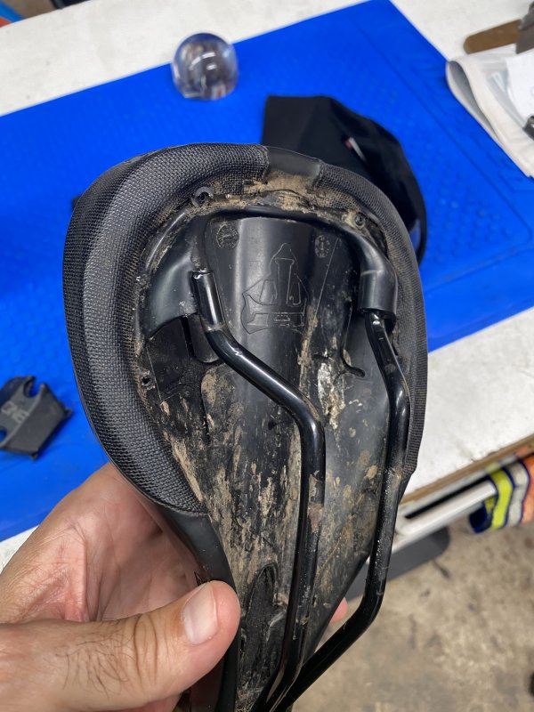

hey all, i went OTB today…somehow this happened too! neither the metal nor the plastic wants to play nice and go back home…anyone ever come across this and have any ideas for a fix? thanks!

I fixed one just like that many moons ago with a vice and a large prybar. It was a sheer act of will and in the end a waste of time, it never felt right afterward.
Use the seat post rail mount to grab the one side that is out and deform it back until you can get it back in the hole. Easier with two people.
i was thinking this might be the solution - but worried i might weaken the rail and then, as @Frank mentioned above - it would never be the same
What I described is hard to explain but I've done it numerus times as the saddle I love is prone to breaking rails. Think of just grabbing the one side that is out and flexing it using the rail mount of the seat post.
There is only one way. I've done this a bazillion times on everything from plastic BMX seats to MTB seats.
- mount seat to seat post,
- Mount post in bike,
- Hang bike from a ~1/4" diameter rope, looped around the empty seat rail socket in the seat,
- Bike should be able to hang freely, front-wheel-down,
- Gently pull the bike downward until you can flex the seat base and socket far enough to re-insert the rail.
