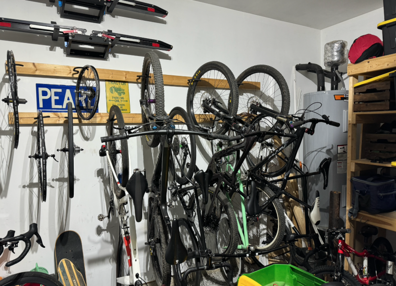

I had a diy solution in my garage similar to the space rail and gator systems. It was just a ten foot long gas pipe suspended from the ceiling with 'S' hooks to hold the bikes. You can slide the bikes together to save space but here's why I ended up ditching it to go with a different solution. It will be rare that your bikes will compact nicely, handlebars get in the way, and pedals smash into your nice paint or carbon. You could fit some bikes with bars inward to add options but then it becomes cumbersome handling the bike from the tire side. I'll try to find a pic, it was before I started MTBing so most bikes were old steel road bikes and we weren't riding 800mm bars.
I ended up with this design which has on the most part worked out well. The hooks are staggered about two feet apart on each 2x4 and the lower 2x4 distance to ground was based on the bike with the longest wheelbase. Having two levels ensures the bars don't contact and is easy to wheel the bikes in and out. Sometimes I'll have the rear wheel on top if there's obstructions, but most are with front wheels on top. Mounting the hooks on 2x4s make the world of difference as you're not stuck with the width of the studs. My garages are usually deep enough for storage in the back, on the side just seems like a nightmare for parking cars in. Ymmv

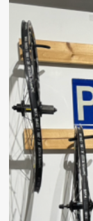

question on this design just for my own knowledge in general.
even tho I see bike hanging from the wheels all the time I have always felt this wasnt good for the wheel and if it is left too long like that it can damage the wheel or get it out of shape? This comes from my own perception only and nothing factual.
That being said, are all the lower level bikes set up to have the wheel touching the ground by design, or in the end it doesnt matter?

Your wheel is strong enough to withstand 200+ pounds of person riding it off rocks and stuff at trail speed, a ~30lb static load wouldn't make me blink an eye. I haven't noticed any wheel shape abnormalities in the years I have been storing my bikes like this.

Complete fakes news, @shrpshtr325 or @Patrick will use physics to tell you why. Btw, how deep is your garage?
The lower level is kind of cool, as mentioned it's height is based on the longest bike. You can 'lower' shorter wheelbased bikes by rotating the tire so the back wheels rest on the floor

this is correct,
the spokes are ALWAYS carrying the load of the wheel in tension, changing where the load is on the rim has no structural effect on a wheel in good condition. You put a hell of a lot more load (tension) on the spokes by sitting on the bike that it will ever see hanging on the wall. The ONLY potential damage that could come from hanging by the wheels is scratches (unless you have sharp hooks or pointed ends on the hooks to gouge up the rims, you dont do you?)

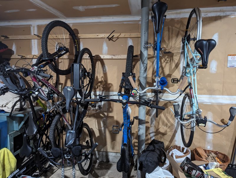

7 bikes in this photo sup bro
and the same design as @qclabrat !
