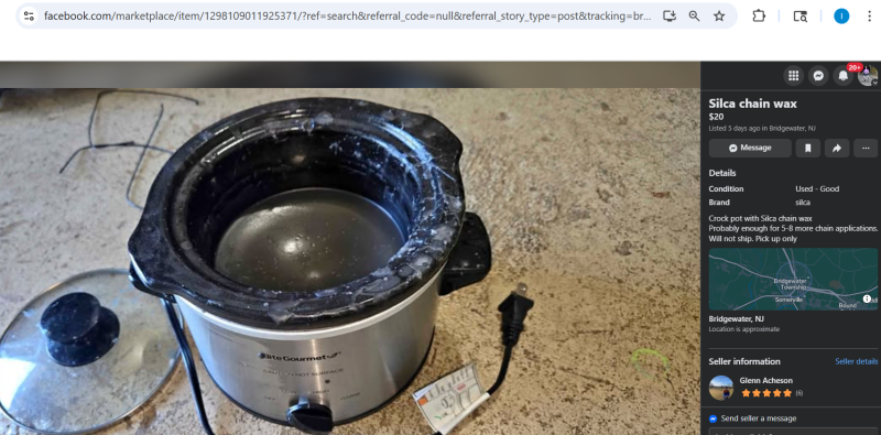

you could just buy this LOLThis isn't helping me NOT spending money on the Silca crock.

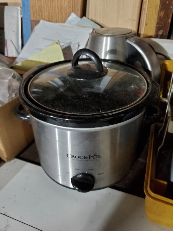

That's what I currently use.
