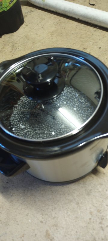

I now have 1300 miles on the road bike and around 600 on the mountain. Still impressed with how clean the wax is but on the mtb it can be a pain if you ride in anything remotely wet.
The melt on is far superior and I find lasts 300 miles on the road bike and maybe 200 on the mtb. The drip refresh is ok but lasts half as long and completely disappears if any wet AT ALL
agree, the melt on is far superior.
And the drip on stuff is really easy to use once you get in the habit of doing it. And doing it so it has time to dry.
