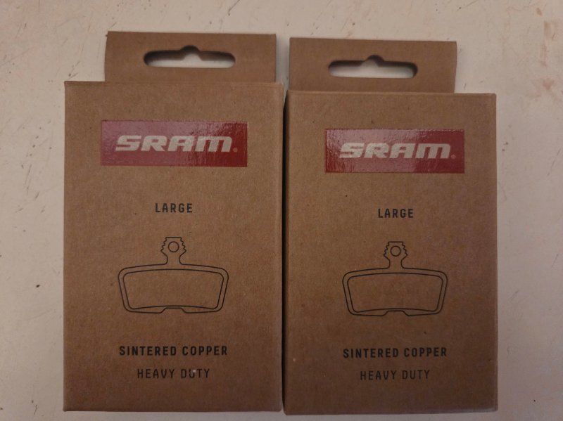

It’s about time to change the pads on my sram brakes (G2 RSC). What’s the go-to? I never had complaints with the stock pads but wondering if I’m leaving anything on the table going with them again.
Stock is fine. Just pick organic or sintered.
