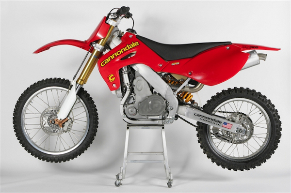

If it's so awesome why didn't they use it here
Or the single strut on any MX?
Sorry I will stop the derail it has always been a pet peeve why the big C wants to throw their stupid front suspension that is and has been the most unreliable from the day's going back to the head shock.

@mattybfat There is no reason to have a lefty DH fork and certainly not a moto fork. DH forks are already dual crown and you don’t weigh things in grams on a motocross bike. What would be the point of a DH lefty? I mean im sure you could make a one sided DH fork lighter, but who cares…not that many people counting grams on DH bikes….and with DH forks being dual crown, there isn’t the advantage in stiffness.

You been away from moto too long @UtahJoe moto heads are counting grams and in downhill you better damn believe they are counting grams. They have become the biggest weight weenies in cycling.
Something that most people don't realize is bicycle suspension has been and probably always will be a trickled down effect from DH racing bikes. It starts from the top. That's how we got to the Pike derived from the boxxer fox cloned there f40s. Point is the lefty comes from where? I been told it's exactly same internals as the Pike in fact I could be wrong but I think rock shox worked with cdale to devoloping that lefty. Correct me if I am wrong @jdog
MX bikes have a minimum weight for competition…just like a road bike. So they cant go insane with lightness. Yes they are always trying to make them lighter…but unlike an XC bike..you wont find parts on it that have a max rider weight of 175lbs. They don’t compromise strength on an MX bike for lightness, EVER. Factory bikes use machined rather than stock casted parts bc they are lighter, but they are also stronger. Carbon fiber hubs that are stronger than shitty cast stock one, also stronger…. You would never, ever find something like my valors on an MX bike…where the manufacturer says “ok, ill give you this insanely light wheel for xc racing….but you know..dont do the redbull rampage with it. Everything on an MX bike is redbull rampage. FIRST. Weight second. You can make an XC bike and if someone takes it off the road to nowhere and it splits in half? Perfectly ok…not meant to do that. MX bikes don’t work like this.
