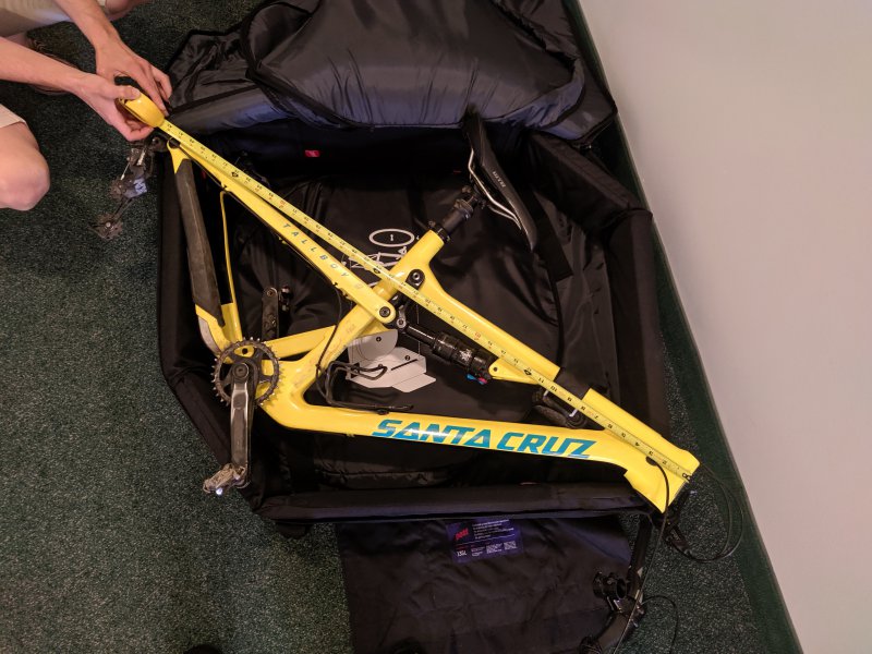

Tuesday I can take measurements with my post bag. I may be tearing apart my medium tallboy, can try it in my post case.
I'm in Vermont.
Enjoy VT!
That would be awesome, thanks for offering.
I feel like the case is a no brainier esp. if I can fit any of my bikes. But the breakaway is still sitting in the back of my mind as an option.
@soundz @Santapez do you think a large El Mariachi would fit in a ninja or a post? I'm pretty sure my road bike would be fine in the post based on the size guide on their website, but the MTB seems borderline / too big. Thanks!
I'd say no on the El Mariachi but you're more than welcome to try fitting the frame in my case. The wheels/tires will be an issue also as the frame is designed around 700C wheels/tires.
I didn't shove my Tallboy in, but it'd fit easily removing one bolt and letting the rear suspension swing.
Although it looks like the Medium El Mariachi will not fit whatsoever, I think it can be squeezed in if removing the alternator plates or all of the bolts minus the top bolts and letting them swing inward.
I think the beauty of the Post case is ability to shove the frame in and it's not something I can do with everything attached. Even the Tallboy picture has the rear caliper & Derailleur attached.
