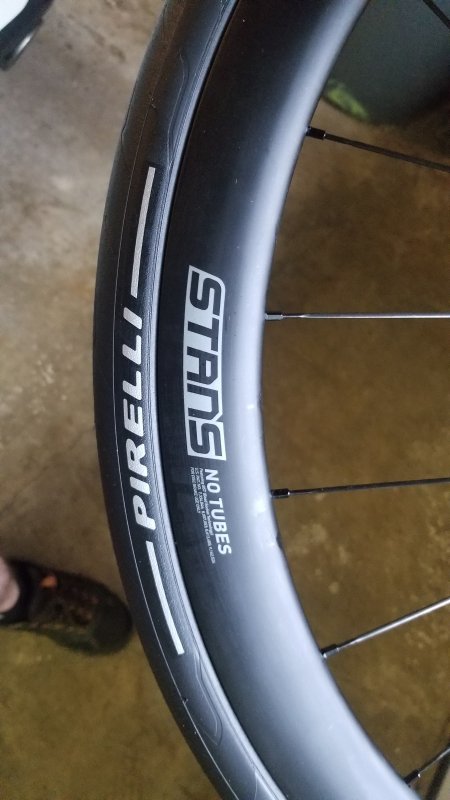

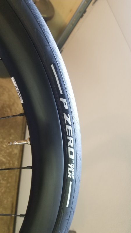

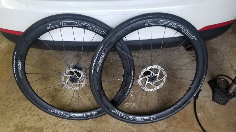

tubeless road tires
Effortless.
Popped on with a floor pump.
