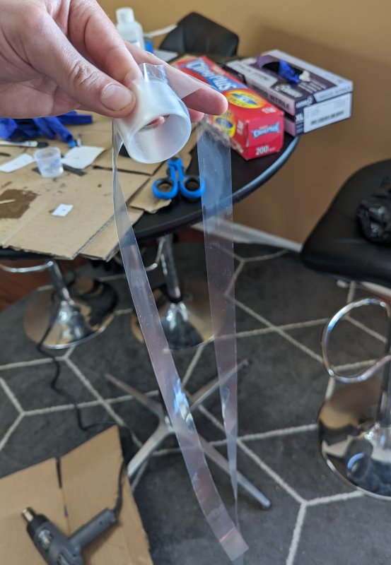

- PRE-CUT the shrink tape and stage it ready to wrap. That stuff is slippery and I had 5 yards of it trying to unravel.

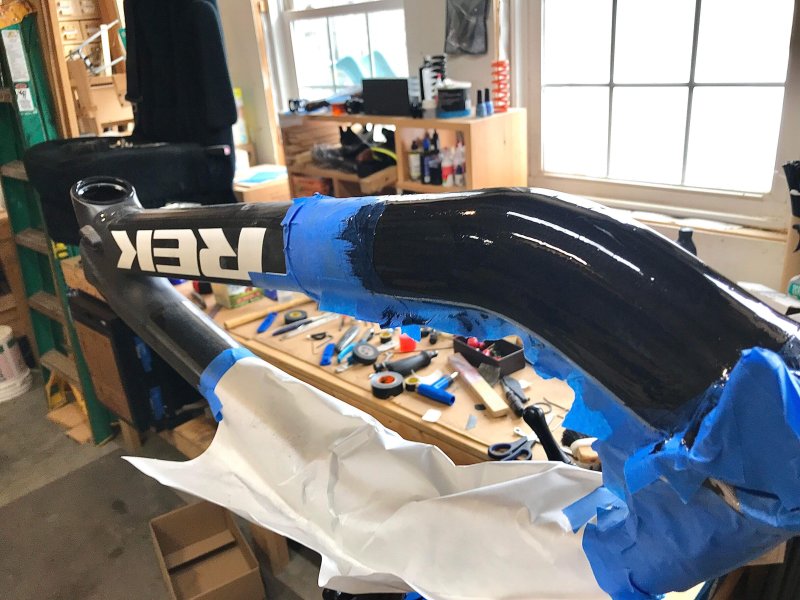

Wrapped!

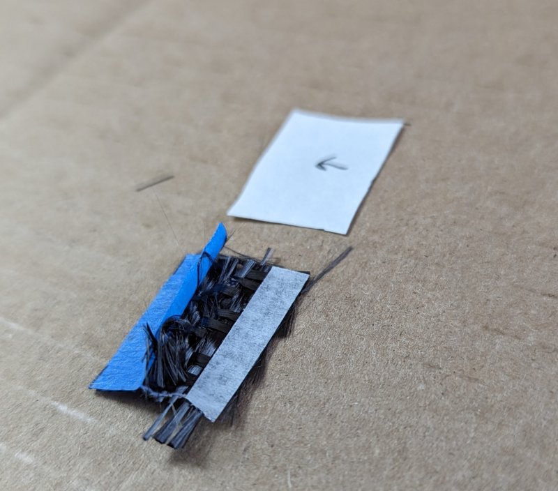

Did the typical template method with paper first. From the research I did, the less you handle the carbon the better since it likes to fall apart.
I thought I'd be smart and use painters tape (kind of like the wax for stickers) to keep the carbon weave together until putting them on the repair. Don't do this, it doesn't work.
Set your OCD aside. The patches are going to fray... Just needed to cut them a little larger than required and move on with life.

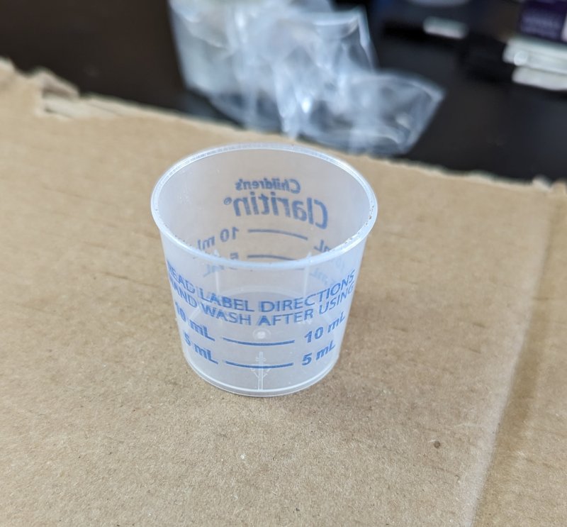

Limited to 10 pics so I'll end with this one, my epoxy was 1:1 ratio... Had an idea to use a little medicine cup and it worked like a charm. This little bit also ended up being way more than I needed.

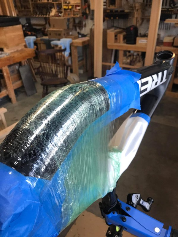

So like I said, I totally messed up by trying to handle 5 yards of this special tape instead of pre-cutting the needed length...
All fumbling aside, it looked pretty good...

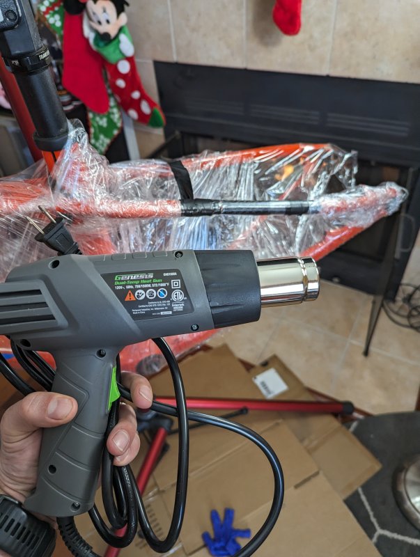

Next up was to hit it with heat. My OCD was kicking in here because the "working temp" of the shrink tape was well below the heat of the heat gun..... So I wanted to prevent overheating it. But I forgot to get my IR temp gun and just went with it, stopped heating when I saw it shrink. It was VERY noticeable and pushed a lot of epoxy out!
Current state with the heat shrink tape doing it's thing

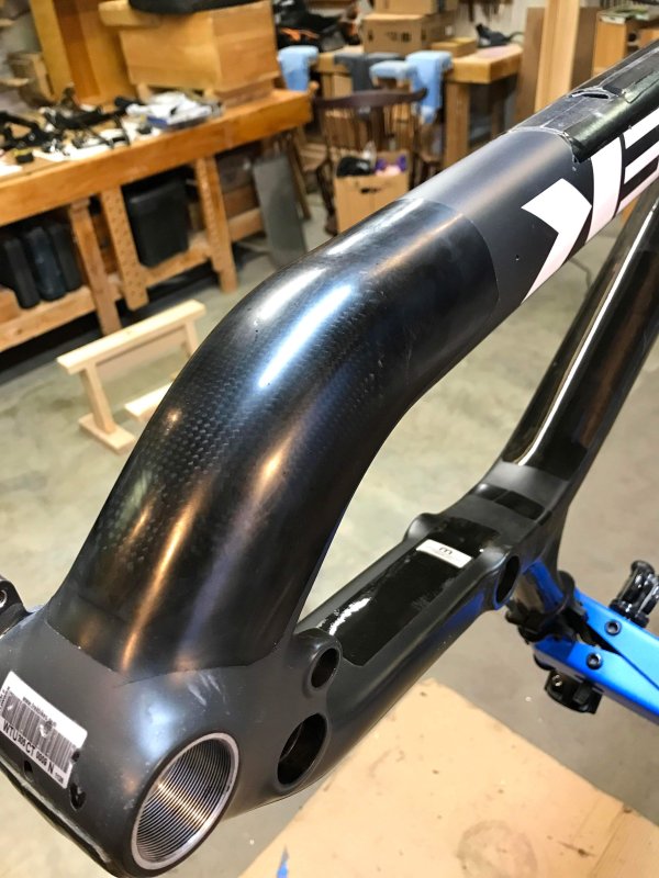

A good friend repaired a hole in the downtube of his daughters Trek Session DH Bike. The repair made it through racing World Champs at Fort William and the World Cup Round at Snowshoe. It was retired at Mont-Sainte-Anne World Cup as she ended up getting a new GT from Wyn Masters winning the privateer award.
