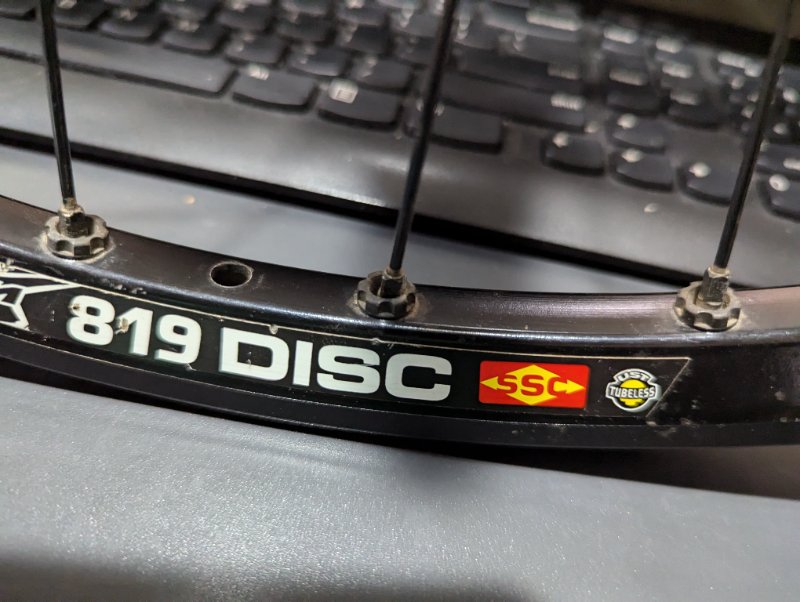

No, but 90-110 kgfcms is a fair target for the high-tension side of modern rims. Lower is generally better, unless you NEED the high tension (typically higher static loads).
Stuff from the 90s/earlier tend to get wobbly/deform at that tension.
