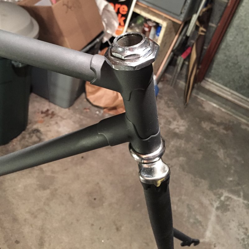

Headset is installed (finger-tightened). There was a bunch of surface rust/pitting on the headset bits so I could only do so much polishing w/o breaking out like 10 different grits of sandpaper and who has time for that.

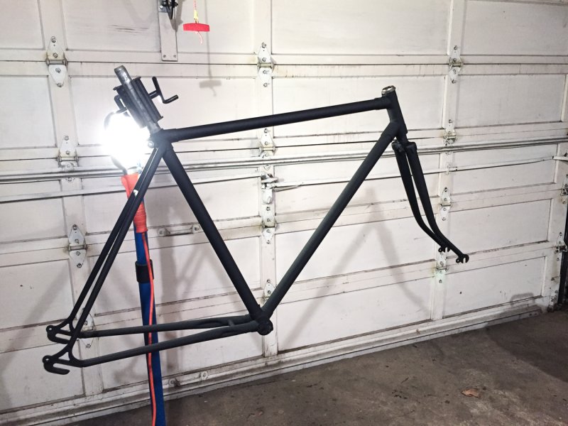

Without clearcoat the paint scratches if you look at it wrong so I suspect it will get beat up really fast. Which is fine because that is eventually the look I want. But it's kind of hard to swallow after having so much time on stripping and painting.
Also, if I wipe it with a paper towel, I get all this white dust on it because of the non-smooth surface so I'll hose it down after I'm all done and dry it with a rag & compressor.

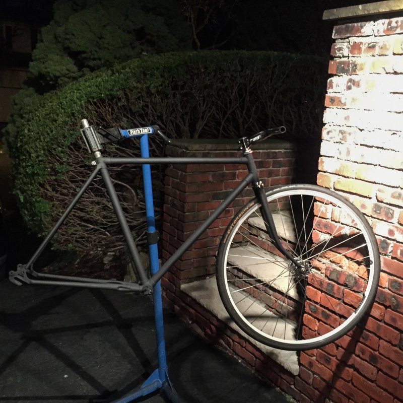

The project is not going as smoothly as I had planned, but still making some headway. The fork was too narrow for the hub spacing, so I had to bend it out and I had to file some threads off the axle to make the front wheel fit.

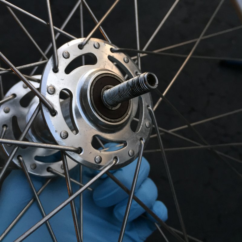

Is there an easy way to remove these bearing? They are kind of stuck in there and banging it against the ground didn't work. The hubs are pretty clean so I don't need to remove them per say, but would like to know for future reference.

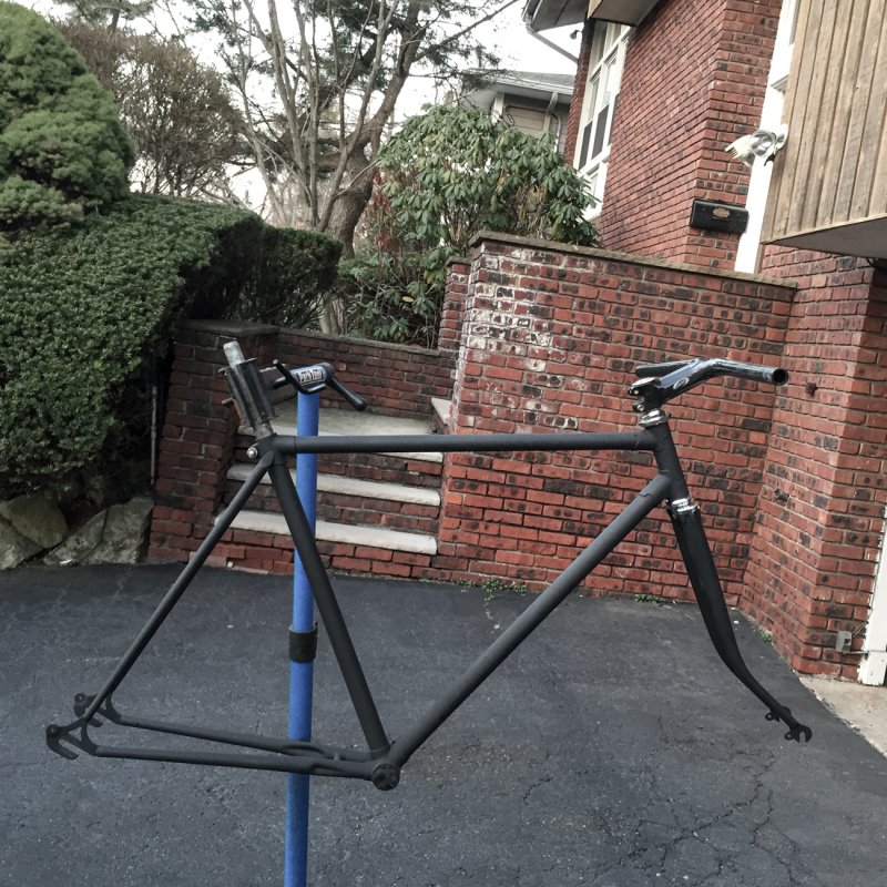

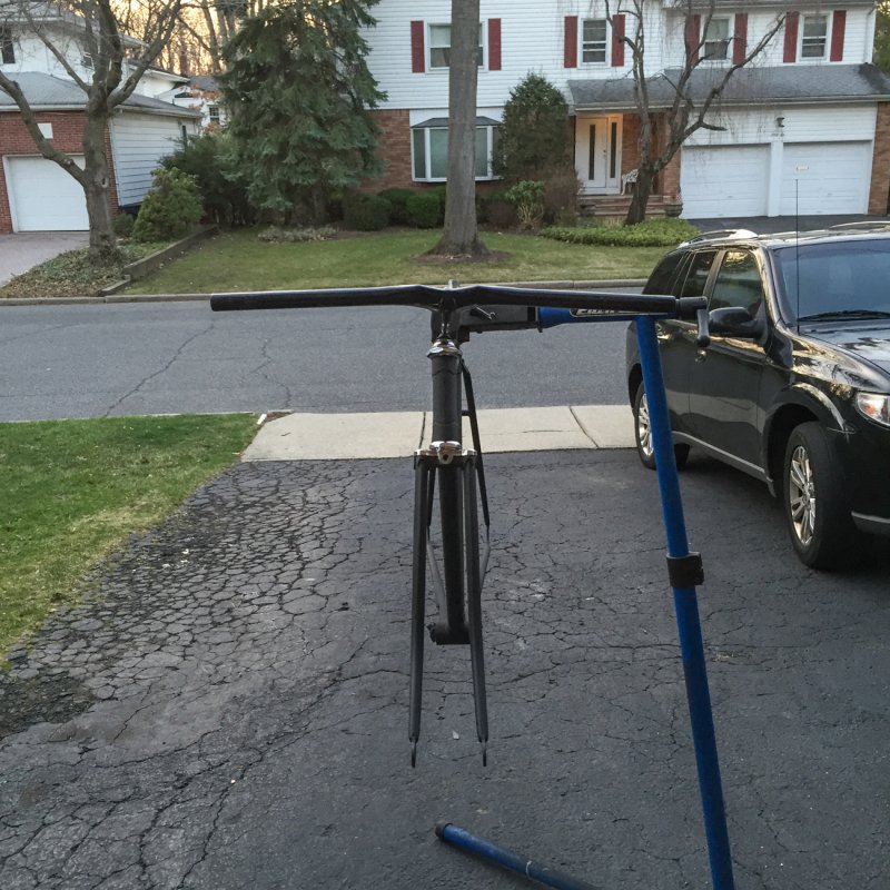

I am unsure which handlebars to use. Here are my choices: racy carbon bars with integrated stem, silver cruiser style, silver bmx style, black hipster track style, normal drop bars, normal flat bars. I can use either a quill stem or a quill to 1 1/8" adapter and use a modern stem. I'm leaning toward the racy carbon bars - I think the adapter looks fine when it's slammed:
Starting to look like a bike:
townie bars.
the bearings get knocked out from the opposite side when the axle isnt there, just like a skateboard wheel
Axel doesn't slide out doe.
guess its held in there by the bearings. a few stiff, carefully placed whacks with a mallet on the axle should take care of it.
sealed bearings last years though unless you blast em with a pressure washer so i wouldnt worry about it
/edit: what he said^
From what has been said, I guess it's kinda like the pivot point on my SC. To take out the bolt... it took a few whacks with a hammer. Of course a wood block was used. The bearing came off by hand once the bolt came out but they were still in there. It had sealed bearings and when I took off the covers, it was pretty disguisting. Took longer to clean them than to take the whole thing apart. In hindsight... should have gotten new bearings.
