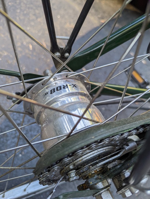

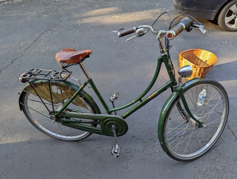

First foray into Sturmey Archer. Lights don't work and shifting is rough on the Pashley. So far not impressed with English handmade.

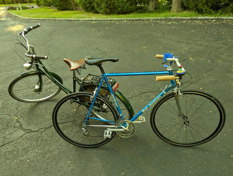

Also working on a better English build, my new coffee getter

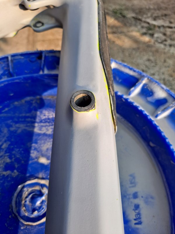

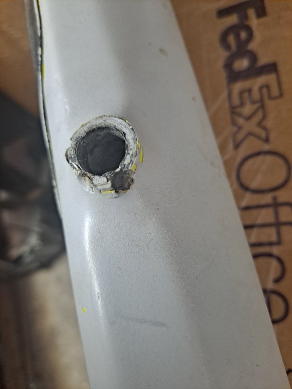

Found a front triangle so I could up size my park rat bike . Let's just say it was in bad shape. Talked to evil about repair and or crash replacement but this would put it way over what I was looking to spend on a 7 year old bike . Decided to fix the problem area myself . One of the suspension pivots were badly damaged and its a main pivot point that a bearing buts up against. Found 3mm thick conical washers so made a jig that allowed me to remove 2.95mm of material from each side . Left a lil extra so I can always clean up with a file if needed . Beveled edges test fit and everything seems fine . Also painted it purple afterwards because purple is best .
Before
Repaired
Painted

Sweet.

If only my works angleset arrives this week I'll be back to creek in no time . Took lots of measurements but I think my redneck frame repaired front triangle now lines up better w swingarm than the original did .replaced a few bearings and gave everything a good going over . Reminds me of my 98 rm125 .

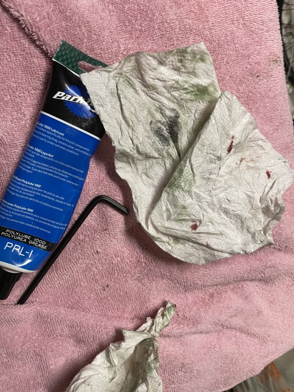

I figured I'd give this a shot since i can't make friends with my Pike. It's been a constant battle over recommended sag vs hitting full travel, more tokens / less tokens, feeling good in rock gardens vs handling big hits/drops. Too many compromises thus far. Maybe I'm expecting too much since I'm comparing it to a ZEB and Fox 36.
I pulled 2 of 3 tokens and added about 10 psi. I've taken it 2 rides so far and it does seem better.

New Pike? I've heard that they are shipped with not nearly enough oil compared to spec.
