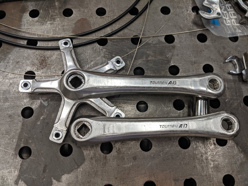

Also got some replacement cranks, not new, but not wallowed out and far less overall scuffs. Should polish up nicely.

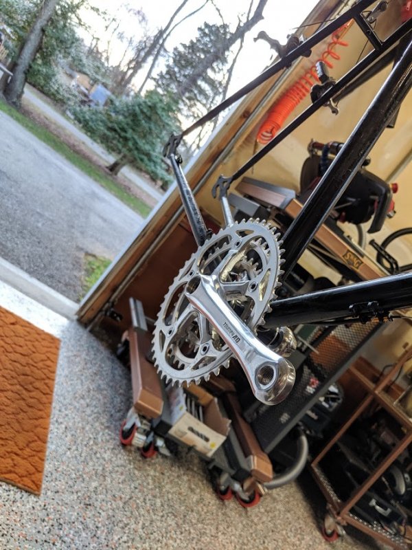

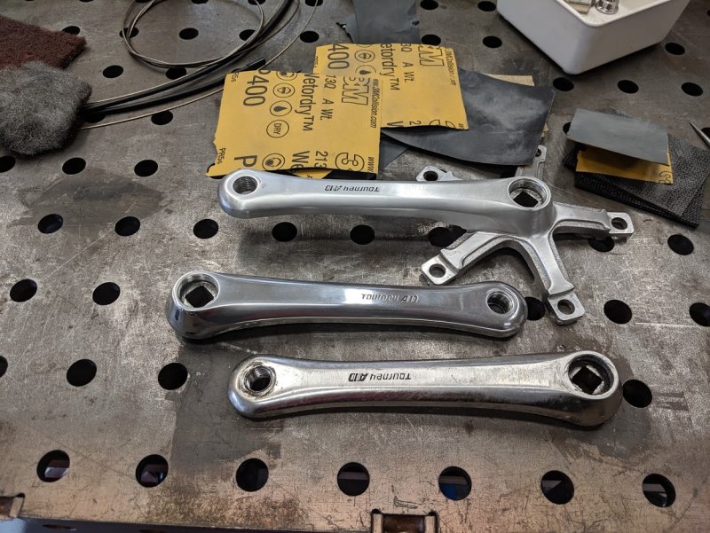

Colder than a witches teat today so i hopped in the shop to clean up the replacement cranks. My original chainrings look ok, just grungy and the new cranks, like most, are scuffed up. Pic of replacements in prev post above.
I thought i could polish out the scuffs and nicks and so armed with and angle grinder with medium and fine unitized wheels, i got them smoothed out. From there i hit them with a series of 400, 600 and 1000 grit paper to buff out the swirls. Finally i chucked up a felt wheel and hit them with white rouge for a final polish to bring them back to an OEM luster.
Top is new crank after 1000 grit.
Middle is new crank after final polish.
Bottom is original crank scuffed to hell.

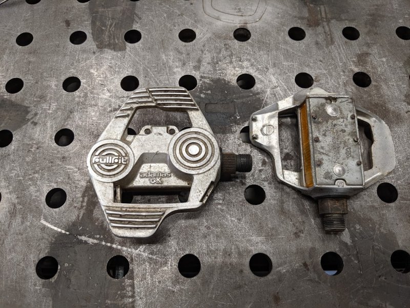

The next item needing some restoration are the funky Shimano Adamas AX pedals. I'm torn how much time to put into them. They're weird and have zero traction but i understand these are actually "clips" style pedals (but i dont have that part). I think i'll clean them up, replace the bearings but not going crazy as i'm not sure i'll even mount them. They take 5/32" bearings which is yet *another* BB size i have to buy in addition to the others i already bought. 1/8 for the freewheel, 1/4 for rear hub and 3/16 for front hub. What's next? Haven't torn the headset apart, is there a 7/64" waiting for me next? lol
I dont know if they were the true originals, but i remember them being on the bike from day one when my father rode it. I have some MTB pedals i'll throw on there for actual riding and keep these for old timessake i guess. Maybe i can get some fun color matched 80's period correct mtb pedals, any suggestions?
