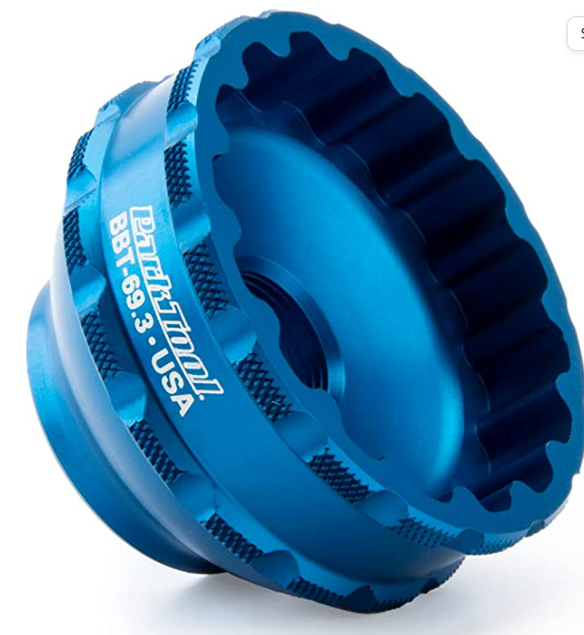

Which tool do I need to torque center-lock brake rotors? Specifically for the rear? The rear wheel is boost spacing 12x148 if it makes a difference.
I bought the Park Tool BBT-69.3 but it does not work out. The side cap/spacer of the hub is too tall and the teeth of the BBT-69.3 does not reach the center-lock ring.
I know the tool below will work, but I am unable to apply (measured) torque on the rotor. Unless, maybe, it is not essential to torque the rotor(s)?

OP, just re read your post, if the endcap is hitting the tool before it engages the lockring just pull the endcap off, they usually are just held in by friction or an o-ring

I need to remove the lock ring to take the end cap off.
well this surprising, pretty sure mine all pop off without removing the disc, you have a buddy with a machine shop could turn the recess in the center big enough to clear the cap?
