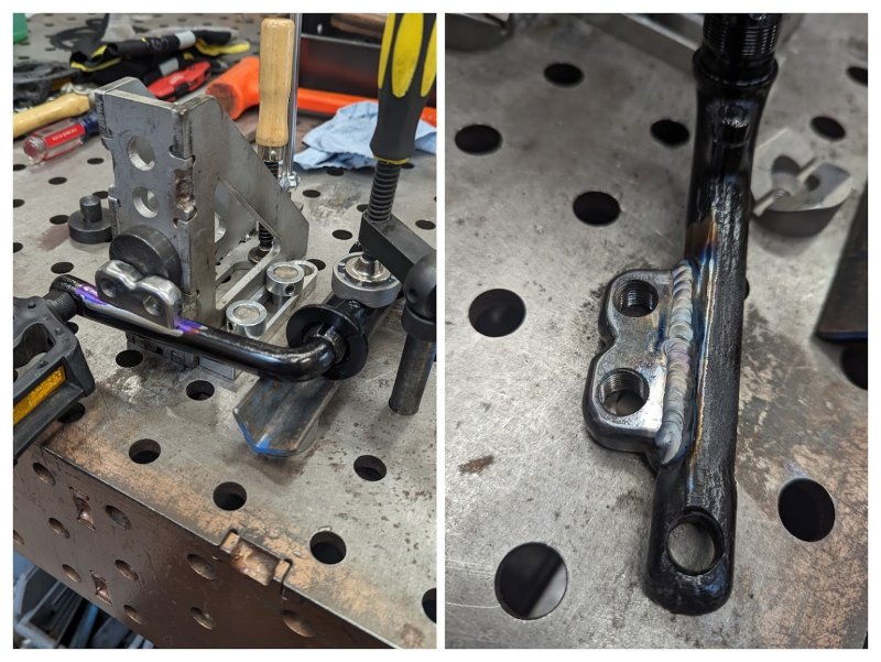

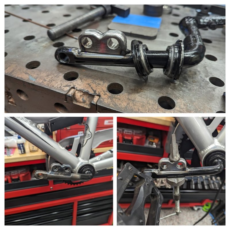

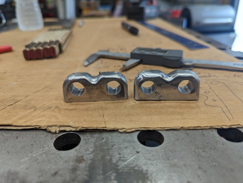

Old school, 1 piece CroMo bmx cranks have a lot of downsides, but they also have one good thing going for them: weldability. With some spare 1/2" stock, i cut, drilled and shaped a pedal mounting boss to weld to the crank arms. With the cranks being 140mm native, i whipped up these with spacing that would go as low as the Woom 80mm and an in-between 110mm (all 30mm apart). The thought is that we can start on the shortest setting and progress through, that is if we still have any interest (you know kids...). I even opted to attach them on the leading face of the crank arms to better handle the massive watts a wee child generates on the power stroke.
The Issue.
I'll stop right here and let you contemplate my folly. Go ahead, i'll wait. Yep, thats right, welding that pedal boss completely blocks all the bottom bracket hardware from ever going on (or off for that matter) so time to rethink this. I decided that i had way too much time already invested and we were doing this no matter what so i would have to pop off the boss, completely reassemble the cranks and weld them on the bike rather than on the fixture table. Luckily the broken tack welds served as alignment locators so i could easily clamp and weld them off the table. It's certainly commitment but you can still disassemble enough to clean/grease the bearings (And lets face it, ain't nobody putting hard miles on this contraption).
Options.

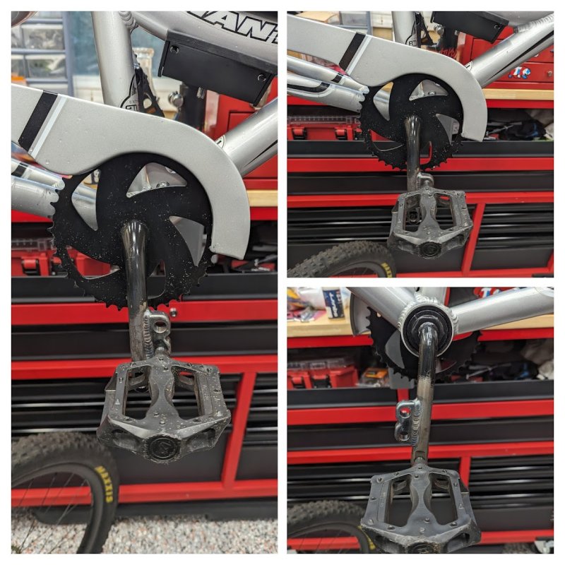

With it fully welded out and holes tapped, its almost time to ride (if it would ever stop raining). Not sure if the protruding section of the crank will be an ankle biter when the pedals are mounted in the shortest position and the cranks swing around, but maybe wrapping some sort of padding around it might help. Hopefully the pedals stick out far enough it doesn't matter but little kid's Q-Factor's aren't much so i might need a solution there. Just need to get that left hand tap for the other side and hit it with some paint and i think she'll be GTG!
A final note, i am doign this mainly so she has a stable place to put her feet without the frustration of her feet slipping off and the danger of dangling feet. I dont really expect her to add any appreciable forward momentum to our 1-ton bike train with her small stature, short cranks and the dubious gearing ratio of this trailer (just look at that 40t chainring), but if she can at least feel like she is participating, thats a win!
The Issue.
Options.

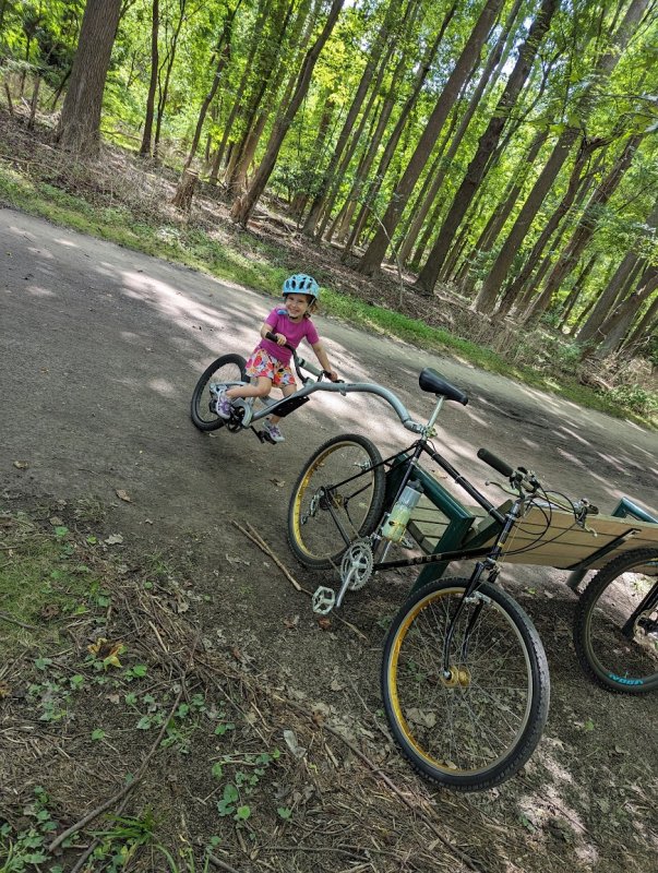

Mission accomplished! After a couple neighborhood shakedown runs to work out the kinks, we finally got a chance to hit the reservoir for a fun family run. With the trailer hitched up to *my* fathers restored '83 Ross naturally, it was time to put in some miles.
Everything worked great but the kid did complain about sand getting launched into her eyes. There's a small fender on the trailer but it seems inadequate for where she sits. I'm thinking either an extended piece of plastic higher up the tow bar or maybe some bolt on fender for the tow bike itself? Any thoughts what might give better coverage?
View attachment 219230View attachment 219231
fender on the tow bike...I bet someplace like second life bikes will have a used set...maybe halters or brick bikes
Yeah, some clear glasses might be a good, simple solution (have to try to not lose them lol).
I have a set of fenders that would work for that. Adjustable, the rear could be adjusted to cover the rear wheel almost to the ground in the back. Took them off a bike I bought. You can have them.
That was a problem I had when I used to tow the kids around in the trailer, got all kinds of debris in the trailer and on them.
