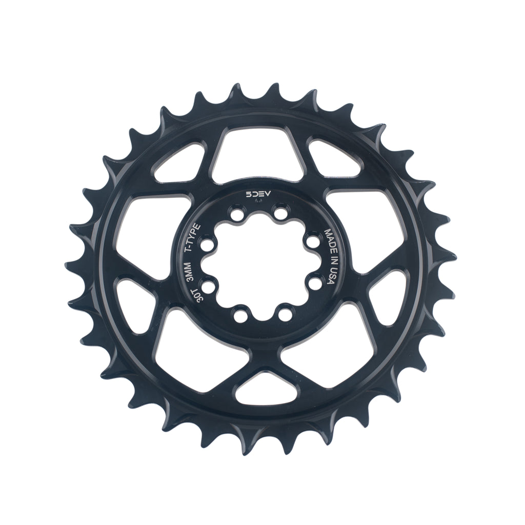

Are T-Type chain rings made only for the flat top T-Type chain or will a regular SRAM Eagle chain work just as well? I'm asking because there's a chain ring I'm thinking of getting but it only says T-Type and I have the older AXS system.

  1. Eagle Transmission T-Type chainrings are compatible with Eagle chains, so they can be used on Eagle Drivetrains when mounted to an Eagle Transmission crankset. However, Non-T-Type Eagle Drivetrain chainrings are incompatible with Eagle Transmission T-Type chains.

5 dev makes a T type chain that works with AXS and Shimano 12 speed chains. I have been using one for 800 miles now without issue.

This is exactly what I wanted to hear... I think... because this is the chain ring I'm looking to get. When you say 5 dev makes a T type chain that works with AXS, did you mean a chain ring, not just the chain? Thanks.
Its works with all chains and they have the new 8 bolt and the old direct mount pattern.
