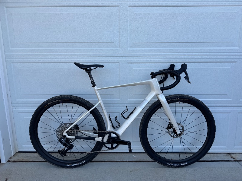

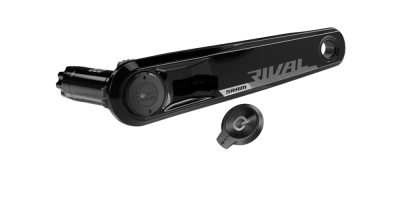

cant figure out why this thing keeps connection/disconnecting when im riding, it drives me bonkers. I made sure it was installed correctly, latest firmware blah. blah blah.

This happens indoors and outside?
Does it still happen on different things connecting to PM? (Garmin / iPad/ etc)

New battery? Re-pairing? Power meter reboot?

i swapped out a battery, reinstalled, repaired, firmware is up to date, im curious if i try and test without the pedals nearby, it wont keep connecting/disconnecting. since theres tons of signals floating around sitting in the garage versus being outside in the real world
gonna try and ride outside and run my watch with quarq, garmin with pedals... see what happens

Ah yes, the blah blah blah technique. Very helpful for others helping you troubleshoot. Just sayin bruh...more detail the better. We're working on limited info.
