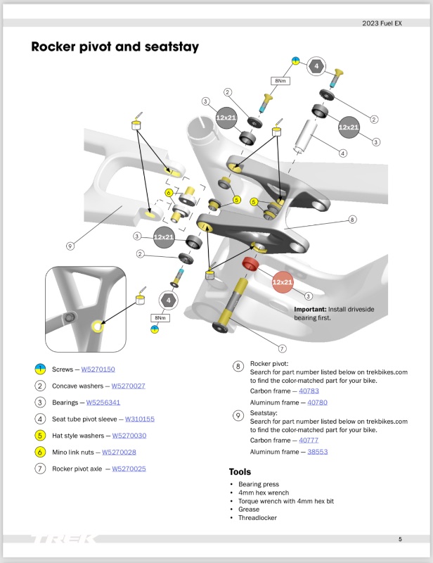

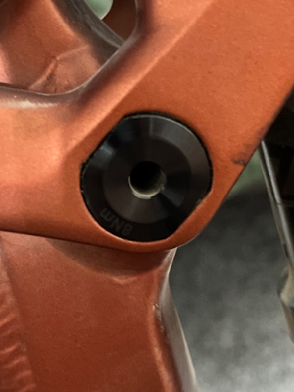

I found the creak in my bike. It’s repeatable and isolated. My trek has a pivot bolt that is squared off round (see pic below). It calls for grease essentially everywhere but the threads where it gets loctite and tightened to 8 nm. (Other pic below bolt #7). Now the issue that happens is the bolt head is smaller than the recess it fits into and gets a bit kitty wompass in the hole and the corners of the head create the sound.
Now I’m unsure how to, if I even do fix this. I can easily grease reassemble and go but this lasts 5-10 ish miles only. I have loctite 620 (park tool RC-1) which I can apply in there. I could go back to the LBS but I have doubts anything there aside from a new linkage could do anything.
Looking for any other ideas or solutions before I attempt anything. I don’t want to anything that is non reversible or destructive.
Brass shim stock, if you want to sit there and put in piece after piece. You can cut it with regular scissors, though you want to take care to make sure it is either flush/below the surface so you don't slice yourself on it.
You could also use large-gap retaining compound between the head and the socket, though it will be significantly harder to remove it later.

99 percent sure it is the bolt I have isolated because I am able to remove, regrease, recenter and reassemble and the creak goes away.
In that case, traditional method would be brass shim stock.
Maybe you could get away with rubber isolating tape if you can actually fit it in there.
Clearances should be fairly tight, so I wouldn't think you would be able to use more than one piece of shim all the way around.
You can get shim assortments from some hobby shops--there's a large one in Tom's River/Brick, if I recall correctly.
Cut a long strip the height of the bolt head, lay it out along the circumference, and then trim the excess. Install it in the socket in the frame first, rather than trying to slip it into place after.
Thanks @Karate Monkey i can aquire shim stock without a problem. I just didn’t know it would work with such small depth. Worth a try as a non destructive
