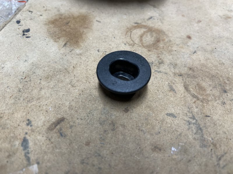

serviceguy
More epic carbon ripping. And solidifying my belief that two is one and one is none. Ti hardtail and full suspension on the radar. Fuck it.. spend money
Wow, is that a BB? How is it even possible to shear crack the BB alloy insert?!?!! I had that happen to me but it was on a crank at the spindle interface, so it would make sense…you know, SS and massive wattage…LOL
Mr.Moto
I was wondering the same. @Mr.Moto which part is designed to break on impact ? I used to crash a lot and only broke 1 WT lever, but it was the little I-spec-b barrel adapter because I overtightened it causing it to break at the threaded cross drilled hole.
Plastic disc. Can buy them on their website. Have an extra if you need it.
