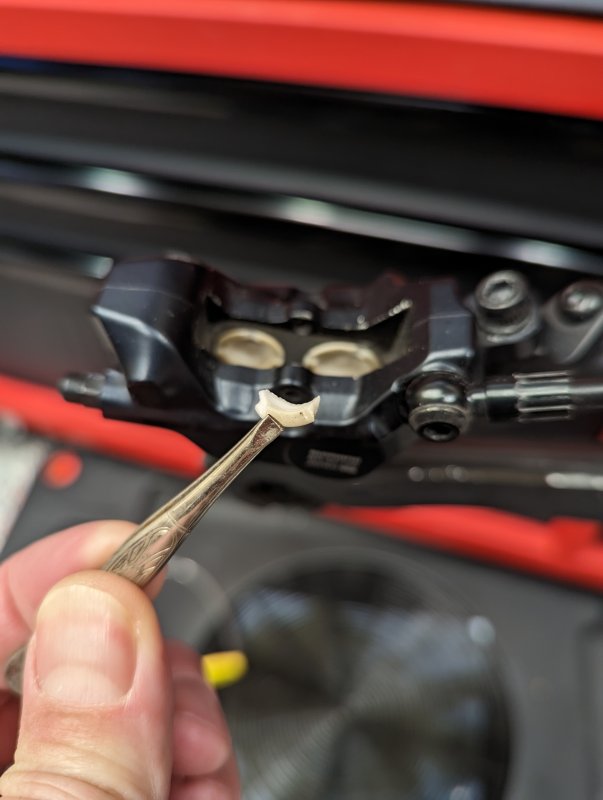

Was wondering why the rear brake didn't feel right.
Also, fsck Shimano for not offering piston rebuild kits. You have to buy an entire caliper and replace. 🙄
2 year warranty on those--would absolutely be covered unless you told them you mashed it back in with a screwdriver.
