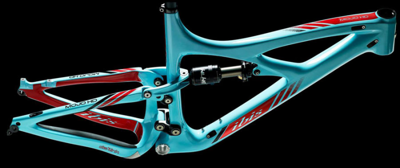

i've been trying to get my head around fork angle, rake, and trail. more from a math/engineering standpoint.
i just about had an aneurysm looking at a dwlink on an ibis today. @Juggernaut ....

Thanks Bill -

You got a belly laugh out’a me over that one. :)
