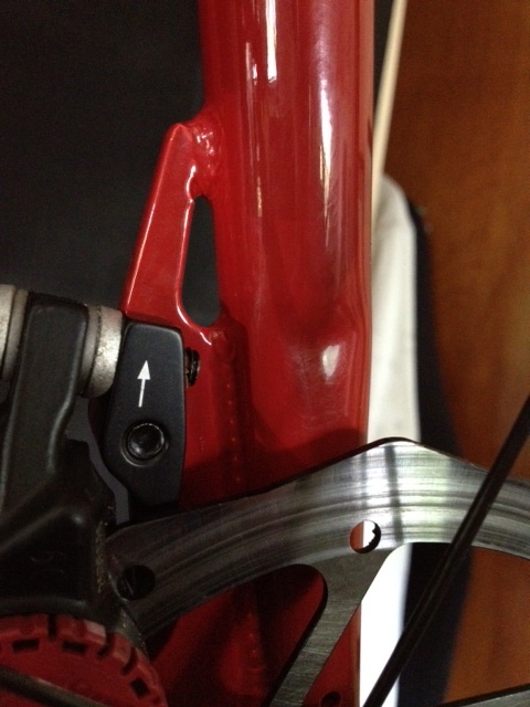

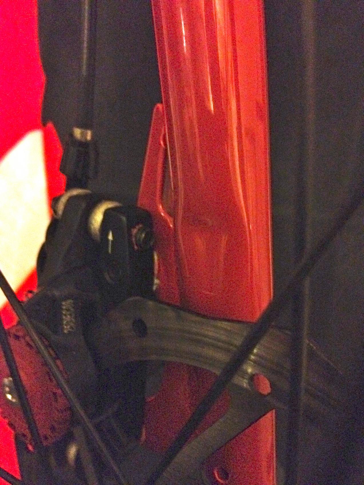

Hopefully I won't find many more issues after this. Anyway, happened to notice a ding on the inside of the left leg this morning on the Raleigh's fork. Overall the dent is probably a little smaller than a dime. It is on the lower half just about even with the top mount on the disc caliper. I had combed over the bike fairly well when I picked it up, so I'm not sure how I could have missed it. Hoping I didn't do it myself yesterday, but either way it is on me if I overlooked it. Could i have come down off a small dip too hard and done this? Basically looking to find out just how big of an issue I should be making of this? Doesn't look like it is about to shear off. In fact there isn't even a nick in the paint. Should I just keep an eye on it and try to avoid hitting small dip and obstacle too hard, or should I start looking for a new fork? Really hate to have to drop more $ into it already, but don't feel like landing on my face either. I have a pic on my phone that I'll try to get up later tonight when I get back to my computer. Any input would be appreciated.

Figured i'd update in the event anyone else ever happens upon the same thing. While looking for info on fork measurements today in the event i end up needing to replace it i happened upon a single mtbr thread on the same crease.
http://forums.mtbr.com/29er-bikes/crease-my-raleigh-xxix-fork-leg-758386.html
It is apparently a crimp to allow for rotor clearance. One reply in the thread only notes it as being on the 2008-2010 models, but one of the links shows a 2007 fork where it can be seen when zoomed in as well. Also seen on the Raleigh page for the 2008.
Attached are the pictures i took today.
