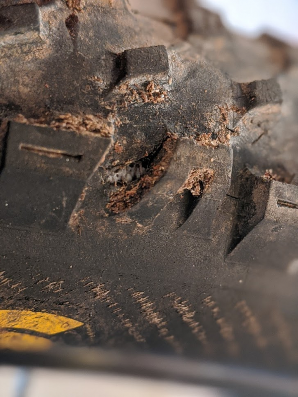

So i pinched a brand new rear tire. After a bit the Stan’s got it and it’s still holding. Normally I’d put on something else but it’s stoopid new and I don’t have anything decent for a rear in stock. So.

classic snakebite/pinch against the rim (aka goon smash).
I refreshed the sealant and crossed my fingers. Seems legit!
If it’s just on the tread I think you’ll be fine. Until you’re not. I just hope you’re not with me when the “not” happens. Are you going today?
Sidewall tear = garbage. Tread you can get away with.
By the bead. Yes I’m going, and now this all means I’d better go do...stuff. Off to plan B!

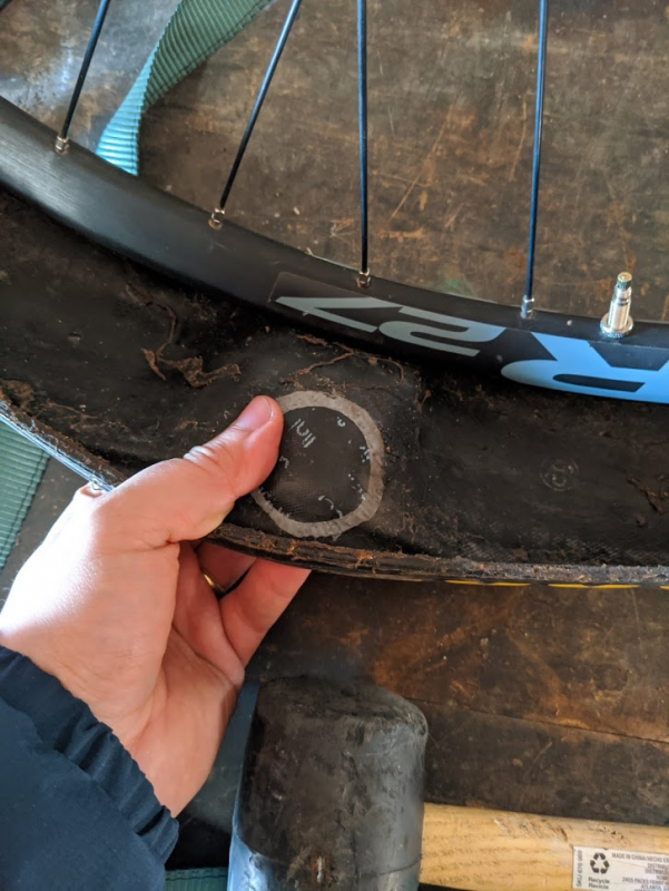

I've had success super gluing a small piece of old tube to cover and seal the compromised area inside of the tire. Tread, sidewall, even near the bead. No sense in throwing out an otherwise good tire. A few years ago I tore a hole in the sidewall of a brand new tire at MCBP. Second run of the year. Patched it when I got home, aired it up and rode it for the rest of the season. Out of the stack of old Maxxis tires in my basement I'd wager 40% of them have small patches of tube glued to them.
Just make sure to clean the area really, really well before applying anything. Super glue isn't ideal for this application, but it works.

I have only had punctures on road tires and I patch them from the inside and use them at +100 psi, with tubes and no problems. I would definitely try patching an MTB tire.
