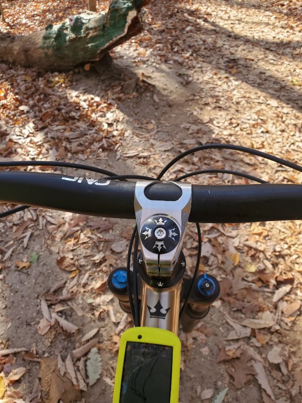

I have a couple of the 76 Project mounts. Love em - but I mounted it to my top tube knowing that it'll be there permanently (or at least a residue will be)
TBH, with a stick on accessory I would be more worried that it would fly away at some point rather than any residue left behind when removed intentionally, Goo-Gone will take care of that.
How to secure do you think it is? do you feel good about about when you are descending down rough rocky trails?.
Tried to remove it once. I'm not concerned about it falling off. Just make sure you get the one that fits your top tube diameter - there's a flat one and one that curves
Looks great, but the one I saw was on insta from some guy in europe, somehow it just came up in my feed, I think it was actually re-posted by Garmin
