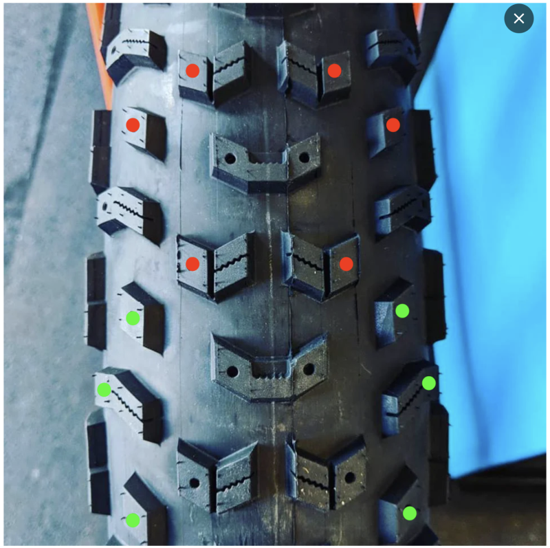

I have a set of Johnny 5 tires I would like to minimally stud. Since these tires have a huge footprint at snow pressures and the times I've needed studs I was well aware of the ice and rolling slowly, I really like the ideal of saving weight from fewer studs.
Do either of the below patterns make sense - Red vs. Green? Or possibly Red on the front tire and Green on the rear tire?
Here is the Terrene factory studding.

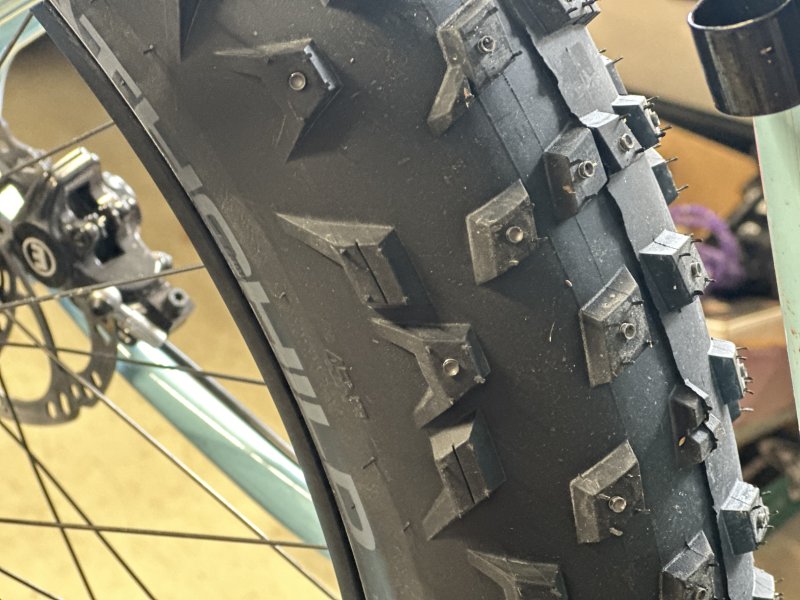

I installed the studded Wrathchildren today - super easy and uneventful. Took a very short loop around the property including ~600ft of pavement. These tires do not lack for traction (or noise)!
What is the collective thought on break-in? Do I really need to ride pavement to set the studs?
