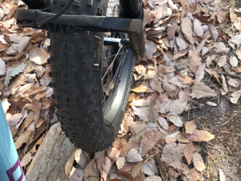

Loving these Barbegazi tires, very happy with them after the first ride! Roll great even on sand and grip pretty good on the trail. Got them just in time, the Cake Eater on the rear was shot after 800 miles. Sidewall was leaking and getting worse quick.
