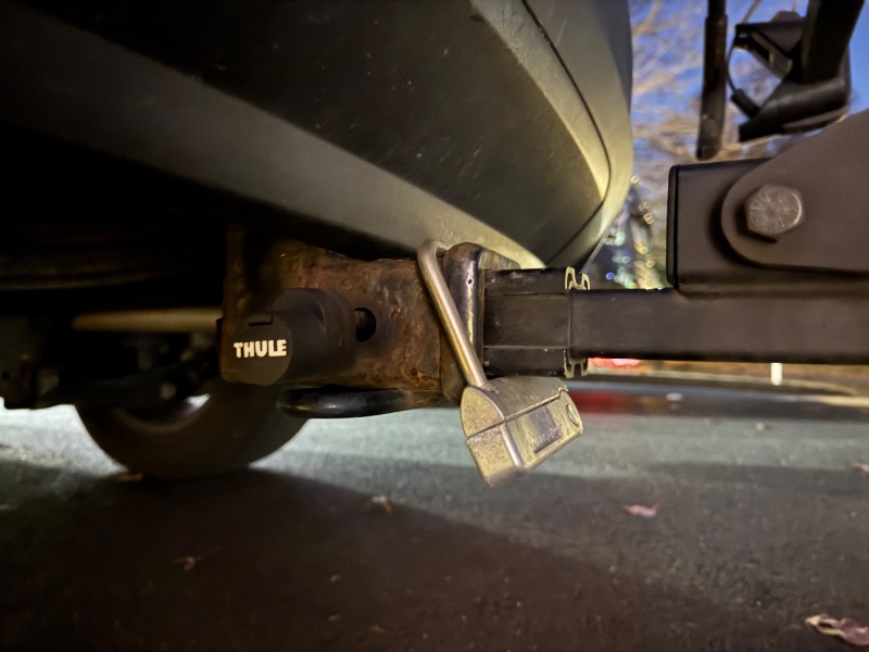

I had a 1.25 hitch and Thule rack.
New car with new hitch. Only was 2”.
Got the adapter but the Thule knob expands in adapter not hitch and there is some play/wobble.
Suggestions??

the Thule adapter?
flip the adapter over to the other corner? (i'm sure you would have figured this out)
looks like this
I have the thule adapter and it has the tiniest bit of play and the rack moves side to side. This fixes that
The play will be in the adapter, not the rack part. I had this setup on my Camaro and it drove me crazy enough to just buy a new rack.

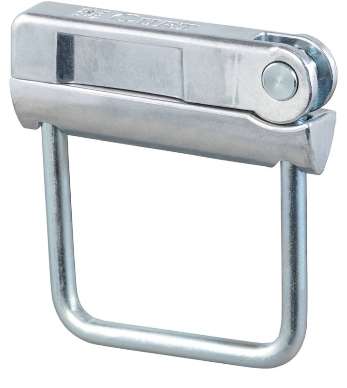

use an anti-rattle plate/bolt between your hitch and adaptor. Like this
I have an extender from my hitch so that my bikes don't hit my spare tire mounted on the rear of the vehicle. It did the same thing until I installed the above. Drove me nuts. You can get ones that fit both 1 1/4 and 2" transition adaptors.
This one fits the 1 1/4 to 2" transition because it has a larger flange.

I bought the above item for my Cargo rack/ramp (not bike rack) as I have a need to sometimes haul stuff around. Even though the cargo rack is also 2" there was too much play in it for my liking especially when carrying a load (i.e. snowblower). This plate adapter works awesome and gives the added bit of security that it will take more than just pulling the receiver pin out to try and steal the rack.
For the original problem, I can at least say that my 2" hitch and my 2" Thule XTR Pro2 once installed does not really rattle around at all; supporting @jdog commentary above.
