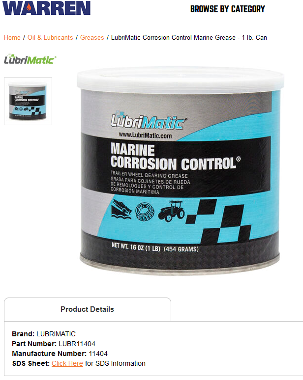

This stuff lasts forever, works on more than bikes & boats, stays where you put it, resists moisture & salt, and cooks you PEC w/P&K, and puts it on a poppy seed roll in the morning. A 1lb can has lasted me decades, and I never had a lubrication-related failure.
Toxic as all fVck tho. Not a dessert topping.
Best thing is, it's Warren-approved.
Yeah, inexpensive Lithium Marine wheel bearing grease is the way to go.
"Expensive" Mobile XHP 222 is still less than $10 for a tube. I'm going on 10 years and I'm halfway through a tube.
Phil Wood is way better in something like a freehub. But if it's ball bearings or surfaces you want to grease, the above style Lithium greases are the way to go.
Lithium greases are the WD40 of grease. It's designed to separate and they thin out fast becoming a runny gummy gross useless mess. I have been looking for an instance where any sort of lithium grease is the best for any application and have yet to find one.
