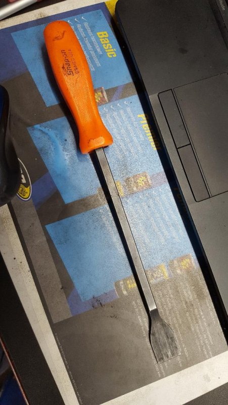

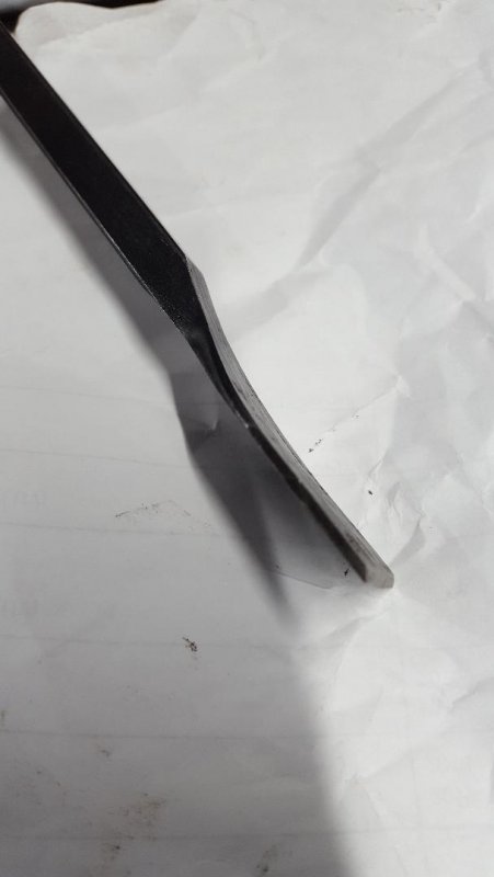

Dingo
I use a gasket scrapper instead of screw drivers. the sharp edge get in the tightest spot. Plus crown races are not a very tight press fit.
Also works great on automotive seals used on transmissions/engines/bearings.
If you think this won't grab the race neither will a bearing puller.
