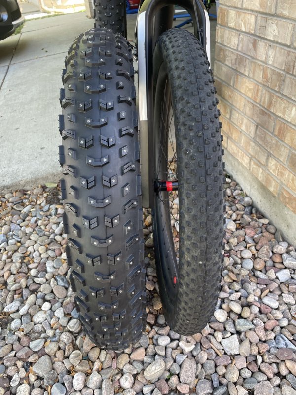

A couple of week ago I was very excited when I got this:
Pampa
I did ask before ordering the frame id B+L on Nextie 105s would fit and they told me "We haven't run into any clearance issues with 26" wheels and tires". I was able to send it back but they killed me with the shipping (2X+ the cost of shipping to me?!, to and from the same points).
In any case, waiting for a Corvus Akio frame (previously Fatback). They told me these would fit. The only thing missing after that is a crankset. I think I'll get snow before I get the crankset but we'll see.
