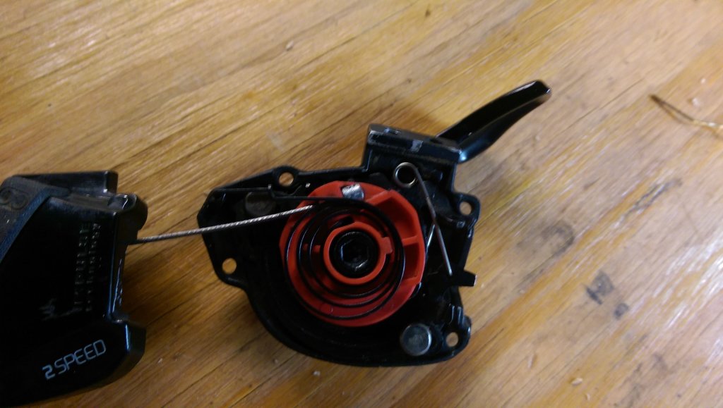

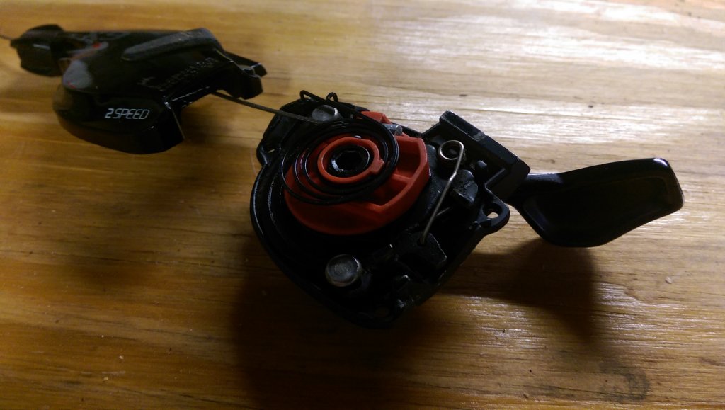

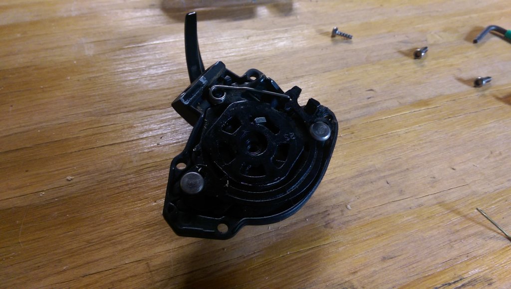

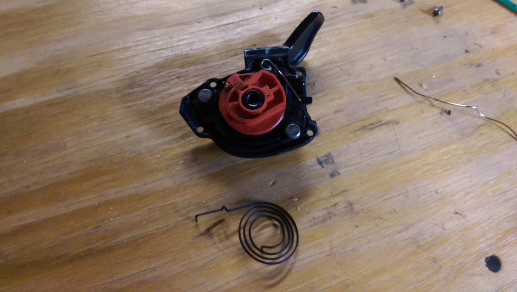

Here are some pictures - basically put the thing back together as it comes apart. The only piece that changes is the sliding metal guide that you need to file down. I probably filed mine down more than was recommended, but it seems to be working fine just as such.
If the shifting lever bottom section falls out of the housing when you are tearing down the device, it can be a real pain to get everything lined up again - trust me. The Art's Cycles video recommends clamping the thing together after the top shield comes off. I recommend that now too.
