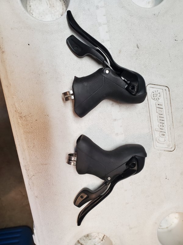

Are those Microshift shifters?
Don't know if they're micro shifters but the worked fine with my mtb gearing
I just did a search for 2x drop shifters/ brake combo these came up price was right and worked great
