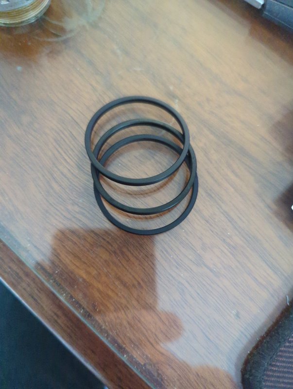

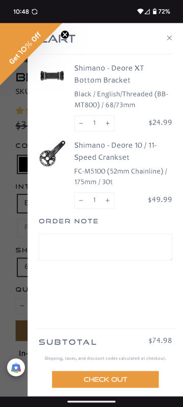

Would these two things work, on my bike, and with each other?
Apologies I'm a complete noob this parts of the bicycle is virgin territory to me
Should work without any issue. Although if a 170mm length crankset is available you may want to go with that.
If you don't have the bottom bracket tool, may as well order now. Your current bottom bracket probably has the larger style and the newer one is the smaller style but usually ships with a plastic adapter.
