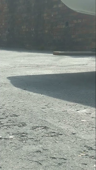

@JerseyPete ran your suggested test yesterday and it's on both sides. Can't really hear it from the first vid but in the second you can really hear the bang at the end.
I've done some more reading online and it seems adjustable coil overs are often noisy, mine are Viking Warriors and a common problem are the lock rings loosen or the top bolt need to be torqued down. I checked the lock rings and they seem tight, but not able to get to the top from underneath. I'll jack the back up this weekend, remove the wheels and look from there. Need to check the differential anyway as I noticed a whine when accelerating and @jklett thinks it's low on fluid.PXL_20210421_125834916.jpg

Are there any "witness marks" anywhere that would indicate contact?
