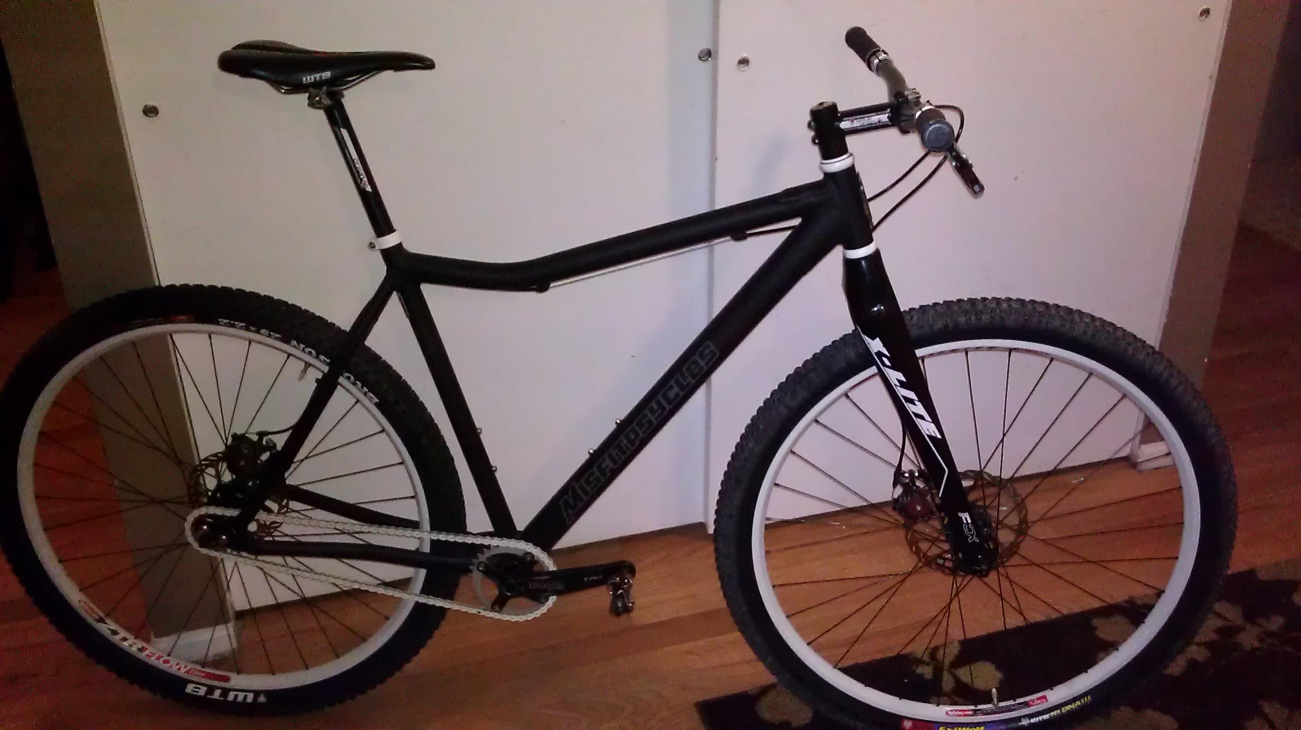

I believe this was originally my frame; attached is a picture of the bike after I had initially built it. Great bike just got tired of the SS Rigid thing. Kind of strange that its had so many owners but its great to see that people are still enjoying it.
I couldn't exactly remember who, cool.😉 When I bought it you had the Reba on it, no? That was a very sweet build.
I will refrain from any off color comments about her being passed around. Family forum!😛
Wish it still had that sweet downtube decal. It's still in good shape, just a few more scratches. I think the last two owners gave it up due to fit, but I will play around with it for a while to see if I can get it right.

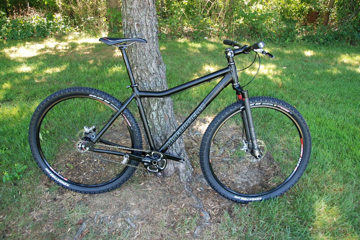

So as my ride was ending on Sunday I started thinking to myself that the fit wasn't so bad after all. In fact I was feeling like maybe I didn't need a layback seatpost anymore. As I was unloading the bike at home I realized why...
whhhhhaaa
were you past the min insert line?
or is there too much wiggle room in the seat tube?
that is a lot of post in general though
you can actually see it was bent in your first pics with the pink trees.
Nope, the min line was still a few inches down. I agree, that's a lot of post but the top tube is so damn low it's pretty much unavoidable. I'm guessing this post just isn't as burly as some of the others out there.
I did notice the tree pic also. Funny thing is the post kept slipping so I adjusted it about 5 times on the ride and I didn't see it then. The seat tube doesn't look funny at all though, so not sure if that had any impact.
Take it from someone who has bent snapped or cracked about every post out there, buy a Thomson and be done with it.

I didn't read your first post but you mentioned your seat is all the way back and that you want this L frame to work. TBH with that much post and seat slid all the way back it doesn't sound promising.
http://bikethomson.com/wp-content/uploads/2013/01/Elite-seatpost-dimension-sketch-for-website-rev_C.pdf
check the layback specs out to see if it's even possible
I met you a couple times at TMs. I know you're a tall man.
Also, it really shouldn't slide down with a bolt on clamp. Either the seatpost dia was off or the seat tube inner dia is off. Can you try another 27.2? It should have some friction between the two. If any 27.2 post drops right down too easily I would shim it with soda can aluminum.
Matty how much post is showing on your Misfit? My hesitation w/ the Thomson is that it only gives 16mm of setback.
Manny you probably have a point on the size thing, but like I said I'm going to play w/ it and see what I can do on this frame. I'll take a closer look at the seat tube and see if there's a problem there.
A lot hence why I too have broken so many. How tall are you?
