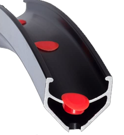

First snarky comment!!! Get yourself some of these plugs. Also, I think I'm supposed to say "light your bike on fire".
Seriously, you have to stretch the shit out of the tape to get it to "suck" into the groove that runs along the center of the rim and stick to the shoulders of the rim. I just did the same thing with breaking a spoke in the nipple. I don't think you're missing anything.

Is there a name for those plugs @mbruno? I have had my share of internal spoke nipples breaking thru the tubeless rim tape.

Velocity and Roval are two of the more common plugs on the market. I have them in my CLX50s with a 28c tire but use tape with anything wider so the bead is tighter. Even though it probably won't happen, I always feel like the tire is going to roll off without tape.
