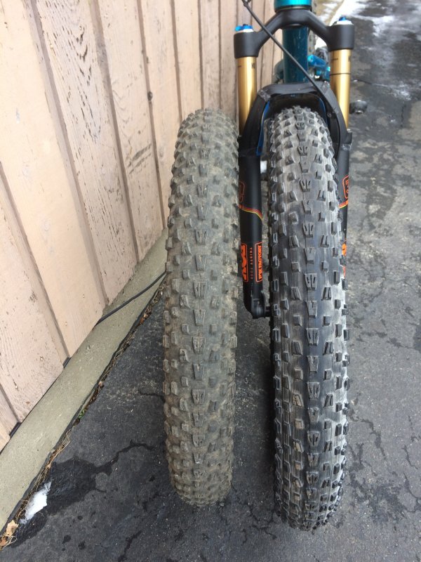

I can compare going from 26 x 4.0 (70mm rim) to 27.5 x 3.8 (45mm rim) on a Salsa Bucksaw. In general, I felt that the handling definitely improved. More agile handling and felt lighter too. I've pretty much stayed with the set up and even have gone to a 27.5 x 3.0 tire now. Never tried a 4.8 to 3.8 swap on my fat bike but would think you would certainly have similar results.
The picture is a little deceiving, but the set up on the bike is the 3.8 vs the 4.0 next to it. Definitely narrower and taller than the 4.0.
