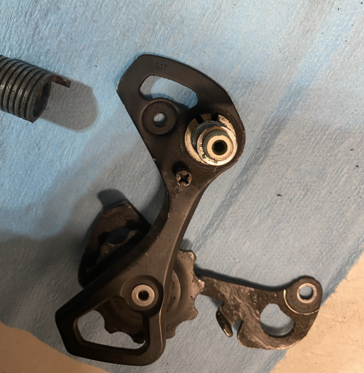

Take the cage off the derailleur. They're are two positions for the spring to go in: high and low tension; they are shipped in the low tension position because it shifts easier, but the derailleur may need it changed as it ages/for rougher conditions.
tried this today, thanks!
spring was in the right position, moved it to the left. was NOT EASY to get that spring, under load, back in!
good rainy day project...
will report back once it dries up enough for a road test, thanks again! wish me luck!
