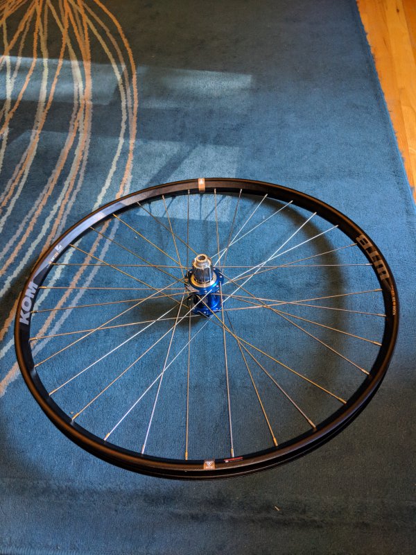

Wheel build help
Going to find out whether the rear wheel is harder to build
I was terrible at trying to tension via sound.

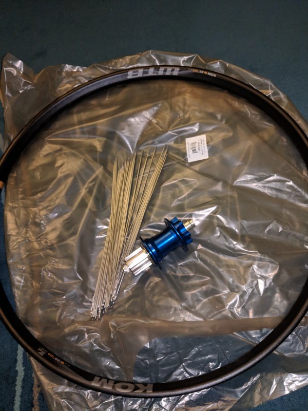

next wheel build project
Swapping a set of XTR hubs laced currently on Velocity Escapes to Alex Adventurer2s (don't ask me why Escapes and XTRs were mated, came that way on a bike I got used)
The ERDs are about the same so planning to reuse the spokes
They are for a touring bike as the "light" pair, as other set has a dynamo front hub
Any tips for this project from those on the know?
